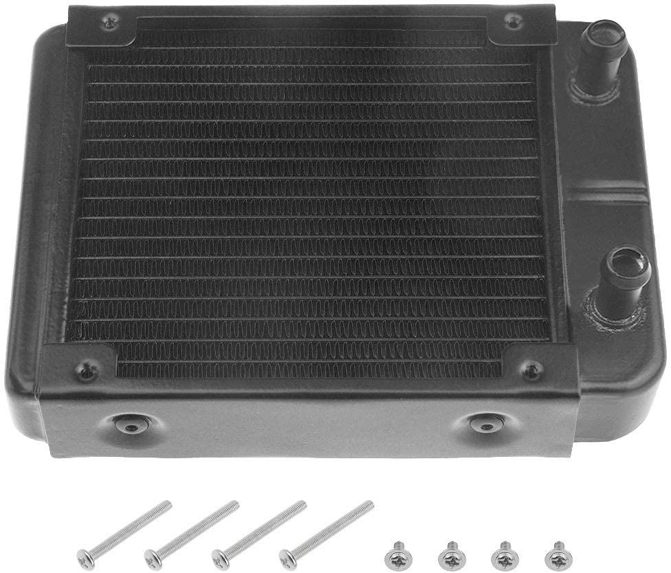

I use a mini fridge. I run the water through a CPU heat sink in the fridge and out to a 5 gallon bucket. My setup is in the basement but I never go over 20c.
