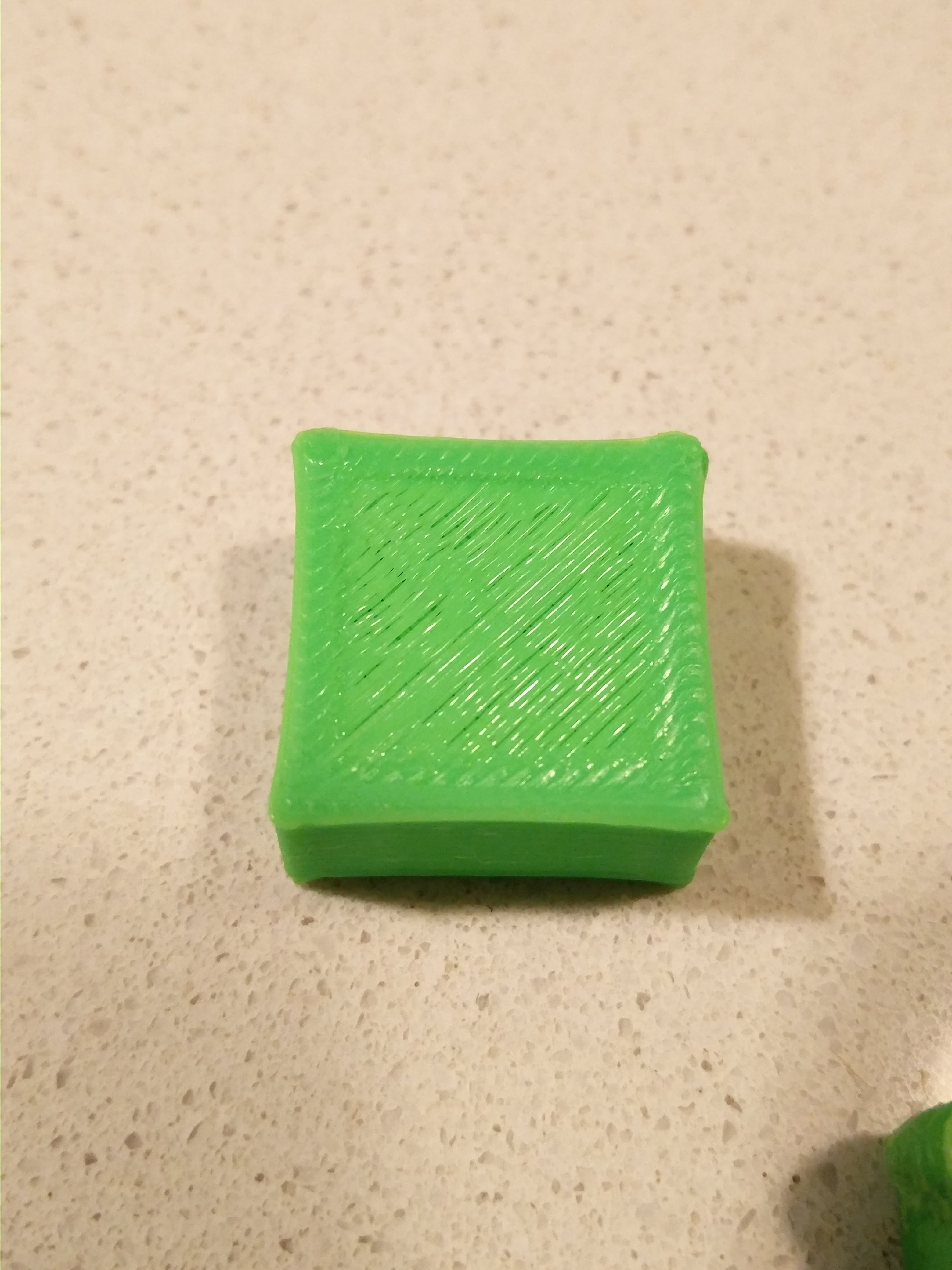

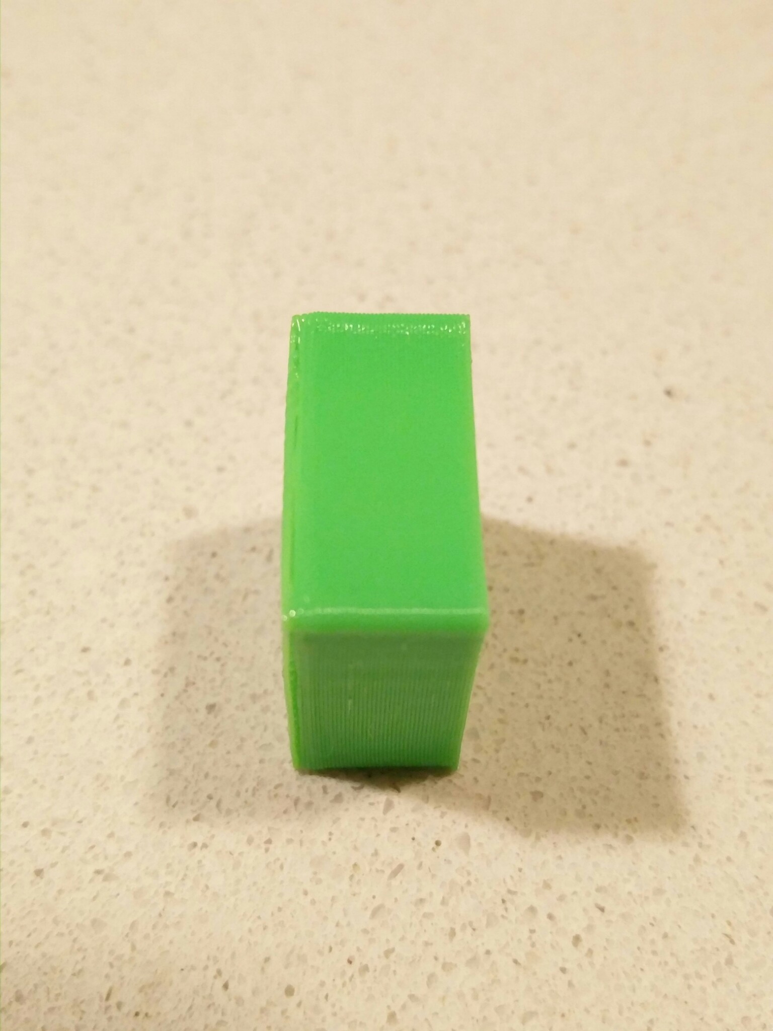

The first photo is without LIN_Advance, the nice ones is with LIN_Advance enabled

Maybe a better photo would be a side view without LIN_ADVANCE
I wanted to show the bulging Corners.
Z speed?
I mean, why do you have such bulging corners in the first place? I’ve almost never seen it this bad.
I wish I knew…
I wish I knew…
What’s your jerk setting?
XY and Z is on 10, and Extruder is on 5

My surprise was that all that disappeared with LIN_ADVANCE Enabled.
It could be due to the pressure buildup due to my very long Bowden tube.
