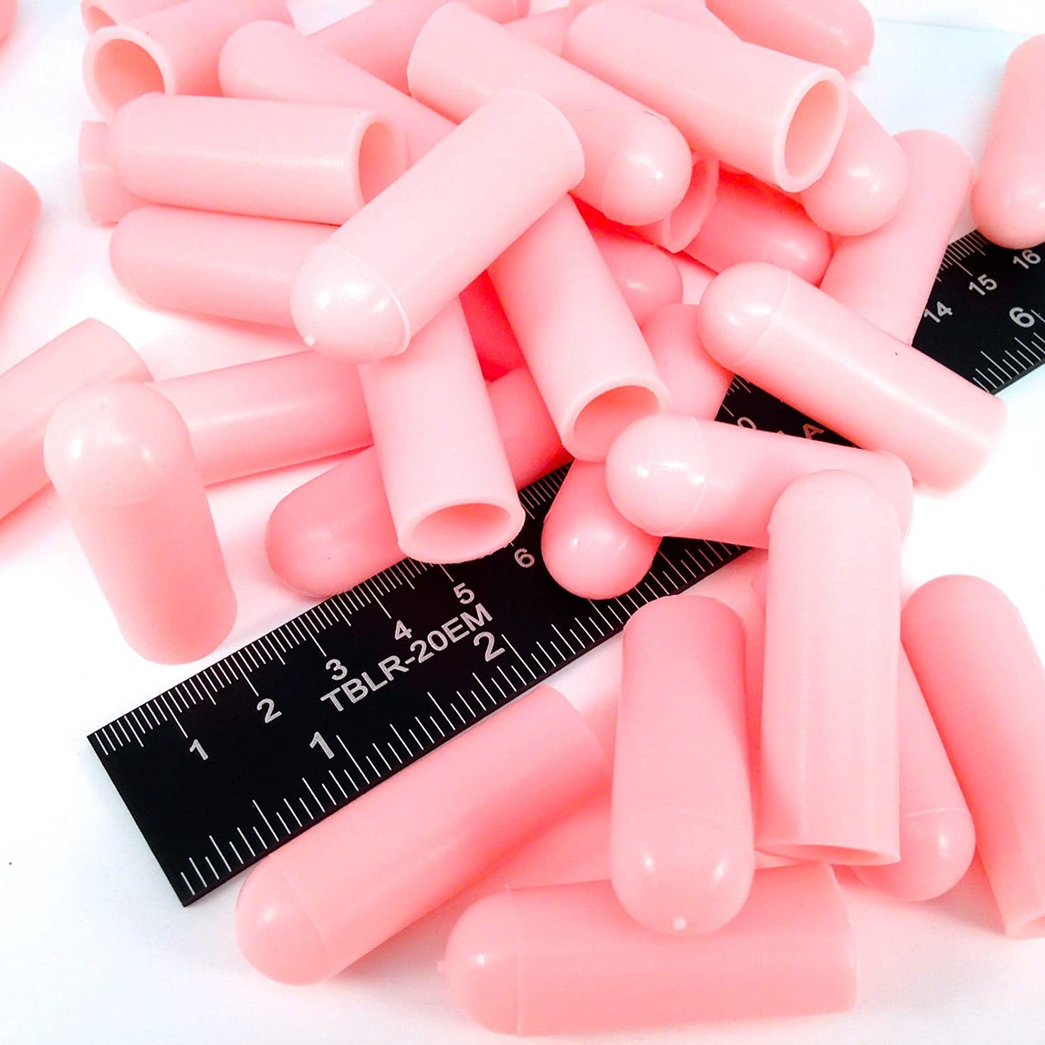

was thinking about sourcing a mini hotend silicone boot and found these powder coating 1/2" endcaps, might work for mini hotend with the tip sliced off and a small metal c-clamp holding it on the heater core. Also considering molding something, but these are good to 315c and the ID of the Mini is .008" less, with wires for thermistor it should fit perfectly… thing is I need two or three, not 50 :stuck_out_tongue:
