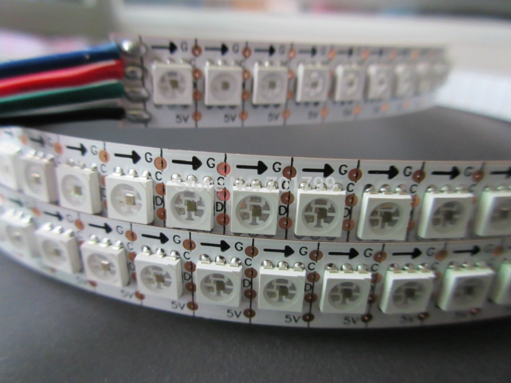

APA102 first speed run reports. With a strip length of ~100 leds, I can run them at 20Mhz. More than that, I have to go back down to 12Mhz. I can run 360 leds at 12Mhz quite happily though.
What does that translate to in real numbers? How about Cylon, with all delays removed, 360 leds, running at 930 fps. (~90 would be the best you could get w/WS2811) - and I can’t wait to play with parallel output with these fuckers, I suspect I can get similar data rates with the parallel output. Folks wanting to do POV with high density strips (you can get these things at 144 leds/meter) - I think you’ve found your toy :slight_smile:

Yeah - one downside to these strips is they aren’t as narrow as the 2812 strips :confused:
