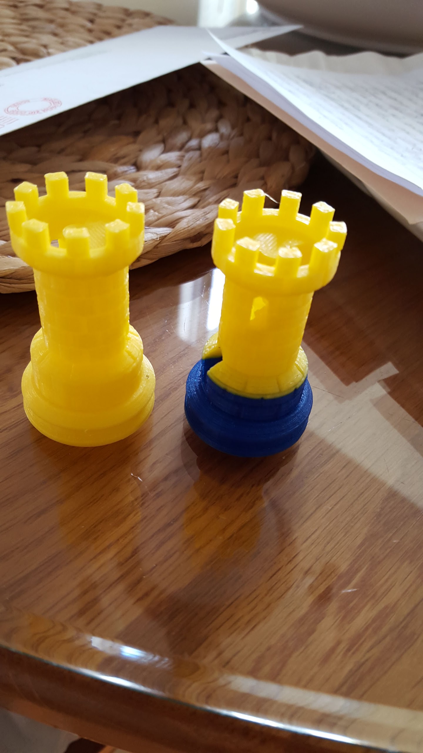

Apparently 1.75mm filament can be fused pretty well...
Apparently 1.75mm filament can be fused pretty well…
Looks great. So did you pause the print and change the filament ?
That’s cool, no purging? I would’ve got green fading into yellow!
What I did was take the blue filament and a little bit of yellow and fused the two ends together with a lighter. That’s it! I was just curious if it would work. There are absolutely no layer bonding problems.
Hi @Griffin_Paquette , how did you manage to get it so perfect that its on the base and not on the top part. Excellent print.
I seamed the two filaments with a hard color change. As in there was no transition of a greenish color. It was just from blue to yellow. In terms of the base transition I didnt really have that planned. It was just conveniently there. But I suppose that if you slice with cura like me you could calculate the breaks and cut your filament to match it. Read the above description for a more detailed answer @Vaughan_Lundin
