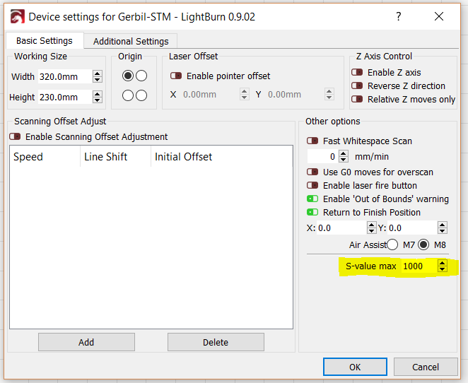

Hi Speedster1, I was mistaken… apologies. $30 is the power range. If you set it to 2000 then it matches 20mA on full power. $31 is the min power, just set it to e.g. 0 or 5
In LightBurn you need to set the value as well.
@Speedster1 The value you set on the digital panel of your K40 defines the maximum power that is used. This defines how mucht 100% in the software is. The software then defines how much power between 0 and this 100% is used.
The $30 configuration of the firmware only defines which number should represent 100%. Usually this is set to 1000.
