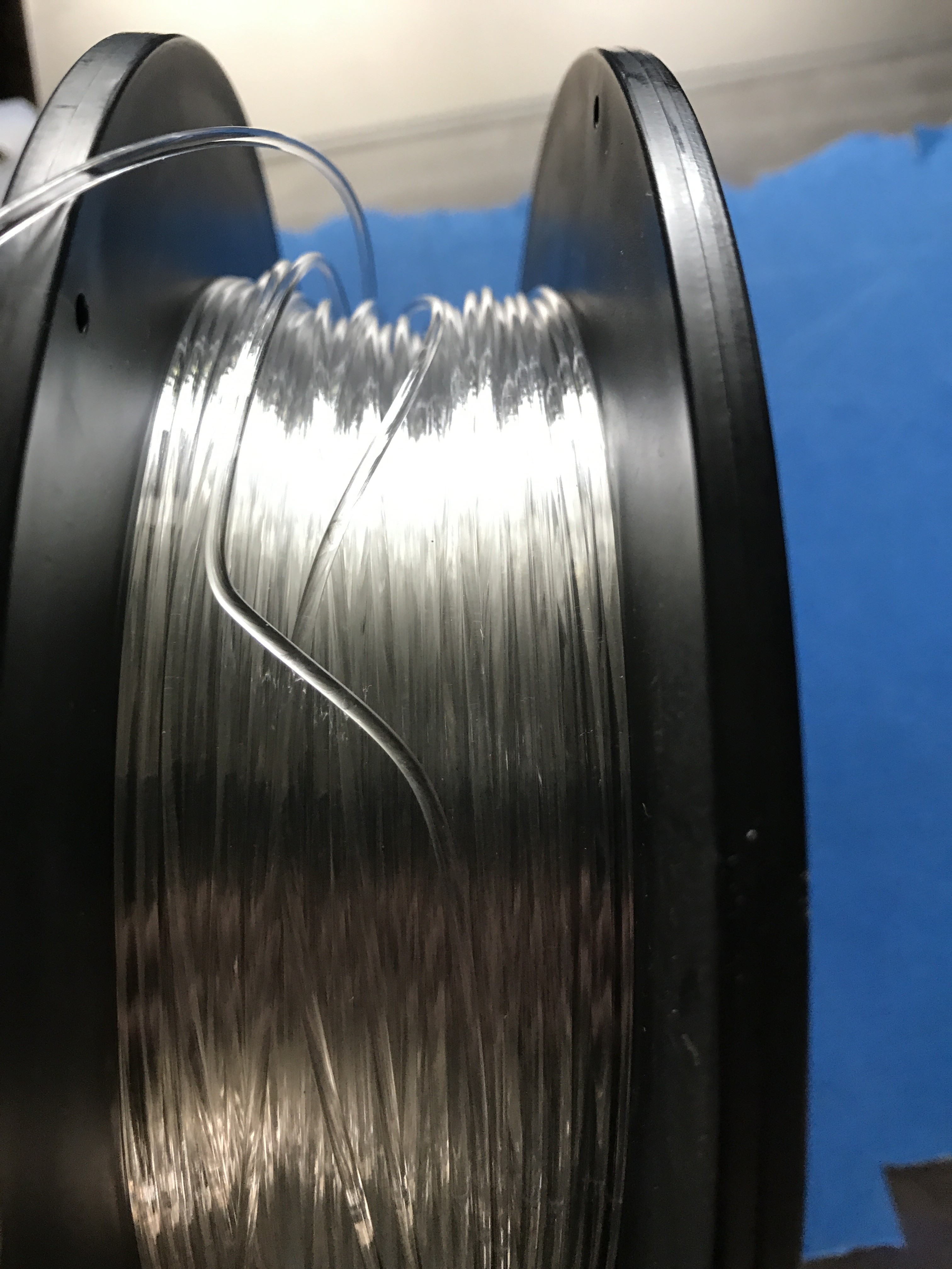

This is the 2nd roll I’ve got from Matter Hackers that’s had the filament tangled. Although I don’t believe this is their fault cause I’d assume it just came from MadeSolid like this?
The funny thing is the cheap Chinese filament I burn through for prototyping has never been mangled, and I usually am expecting to find something wrong with it.
It’s hard to see, but it criss crosses under/over a few times, but I’m hoping I just need to unwind only a few feet to fix.

@MatterHackers , thanks for the follow-up but I was able to fix. Unwound first 10 feet or so to detangle and then unwound about another 30’ to confirm it’s good.
Just so everyone is aware… It is impossible for a spool to be factory tangled mid-spool. It is impossible because of how it is produced and loaded on the spool.
With that said, the factory can accidentally cross over the end while packaging, or you can tangle it yourself by crossing over the end while unpacking it. Or it can be badly coiled at the factory by the autowinder such that it can bind. But mid spool tangle from the factory… Not possible.

@Eclsnowman I’ve had a spool from Surreal that was tangled (the top line coming off was wound under about a dozen rotations, halfway through the reel). No idea how it happens, but people do ship improperly wound spools from time to time. The Surreal filament was fine, but that one experience was enough I’d never risk using them again.
@Jonathan_Challis I totally understand that filament spools can mis-feed. And it can be from bad coiling from the manufacturer, or as I mentioned letting the loose end get under a coil at the beginning. It will start to feed correctly for a while until it takes out the slack and can no longer slider under the other coils.
But it cannot be truly knotted mid spool from the manufacturer. That would assume an end was loose mid spool to create the knot. And if they are respooling off a larger spool, or spooling directly from the filament extrusion line there was never a loose end during the coiling process.
But much like a fishing reel, improper spooling tension or incorrect timing of the transversal head of the spool coiler will lead to coil layers not sitting flat. There will either be gaps between strands or the layer can be over stuffed causing them to over stack. Then the following layer will start with that uneven layer and compound… etc. This can lead to one coil wanting to slide between two layers below it. Now in theory this should never lead to a bind. But as you have experienced… it certainly can cause problems.
