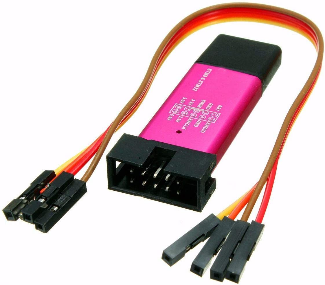

I’m using a ST-Link v2 programmer like this( $10 ):

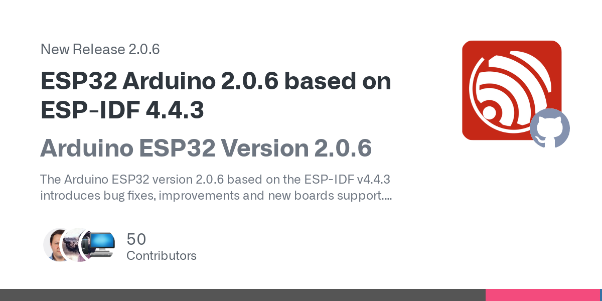

The ESP-IDF team updated the ESP32 Core last week(v2.0.6) and included JTAG debugging fixes for the Arduino v2.0.3 IDE. I tested it with my FTDI FT232H board and an ESP-WROOM-32 board and it does work. So now we have Arduino SAMD based ARM boards, STM32/JLink boards and ESP boards with either FT232H or ESP-Prog JTAG interfaces(both under $20).
