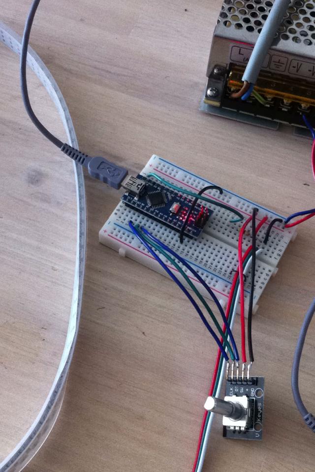

Arduino, WS2812b (122), encoder KY040.
Arduino, WS2812b (122), encoder KY040. Now looking for the right code for changing color and brightness with 1 encoder. No-click = color change, on-click=brightness. Anyone having some code around to finish this thing?

So you’d like fixed colors when you click the switch rather than using the rotary encoder to change colors when not adjusting brightness?
oh sorry, no. all leds (for now) same color and can be changed with the rotary encoder. when i click the switch the rotary encoder changes its behaviour into changing the brightness of the leds.
