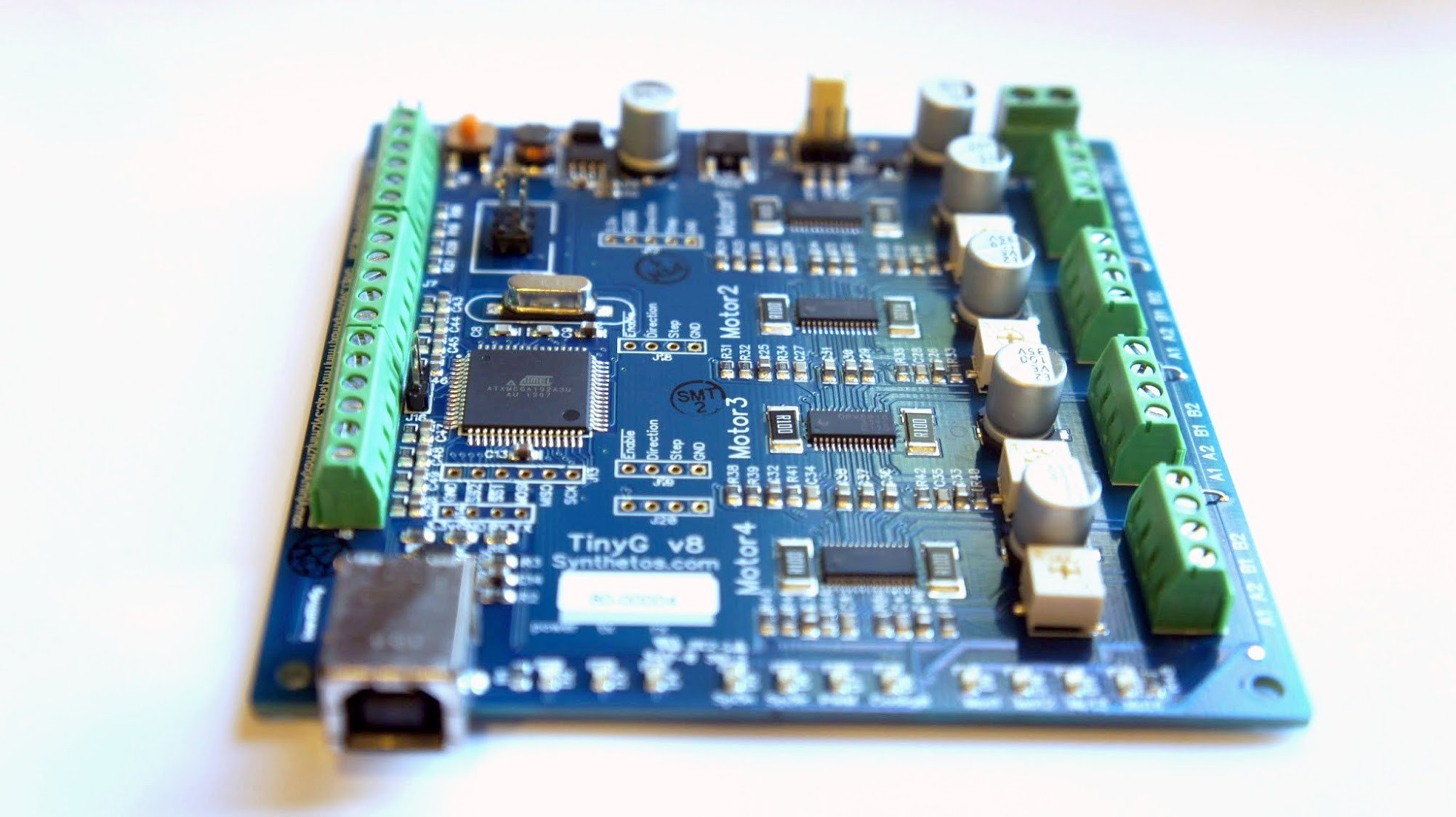

I have an arduinoDuo and gShieldv5. I have downloaded g2core and programmed the arduino using the command line and the arduino-flash-tools-master\bossac.exe, I have the usb connected to the standard usb port on Arduino, not the programming port, and it does connect to the SPJS and shows two com ports, “TinyG G2 (com4)” and “communications port (com1)”. Chilipeppr TinyG workspace runs and recommends connecting with the pulldown set to “tinyG” or “tinygg2”. I have tried both. I see some level of communication with the board, but it does not echo much and the comms queue backsup when I hit any of the Jog commands. (I have no motors connected yet, just wires from the gShield) Is this a good way to proceed or should I try and load the grbl (version 1.1 looks like the latest) ?

You have an arduino board not a TinyG board so I am not sure why you are seeing that port unless the firmware you flashed is for a TinyG. I would think this needs to be sorted out first.
Hi, I represent your confusion, it comes easy to me also. I think/thought the g2Core is supposed to be the Tinyg code ported to run on the arduino and it “was” advertised to be better then the grbl code base, but that was in 2016. I am also thinking about a 4th axis and am wondering if I should just move forward now with a new controller (but which one) or try and debug this setup.
Thanks for the clarification! I do see that it has not had much action in the last few years. Since I have not played around with this combo of hardware/software, I will not be much help.
