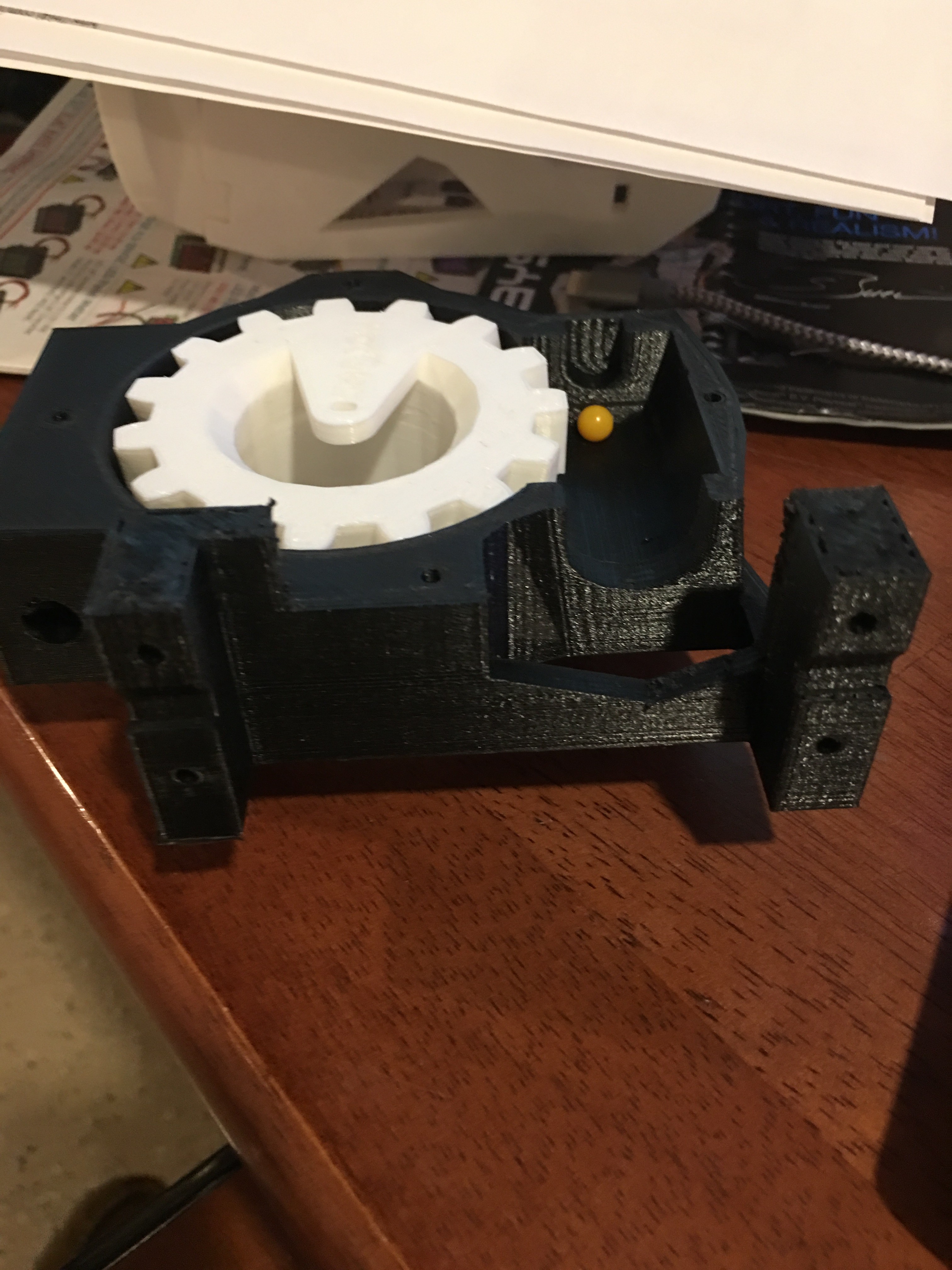

Thanks all again, after some playing with settings, I am getting some good prints with PETG. Hoping they will be stronger that the PLA for my robots shoulder assembly.
@Jeff_DeMaagd @Dennis_P @Eclsnowman @SirGeekALot I was successful, thanks for the tips!
@Bruce_Lunde Glad to hear it! I’m curious about your robot though…
