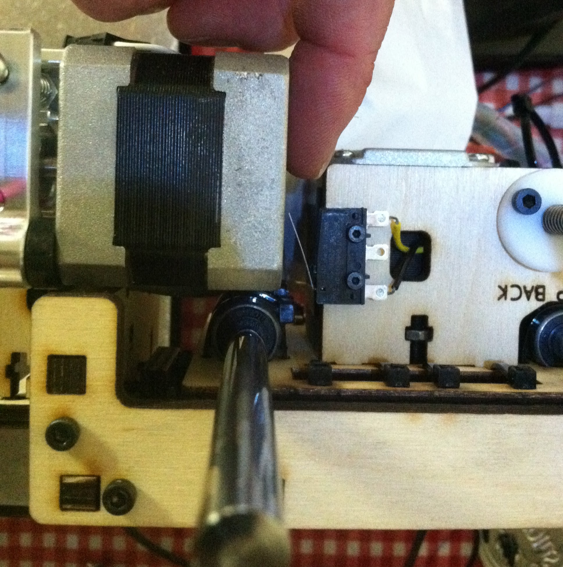

Because I’m working with the original motors, the body isn’t long enough to touch the limit switch! I found out the hard way, grinding y axis, quick yank plugs style.
I’ll kludge up something then design and print an adapter.
