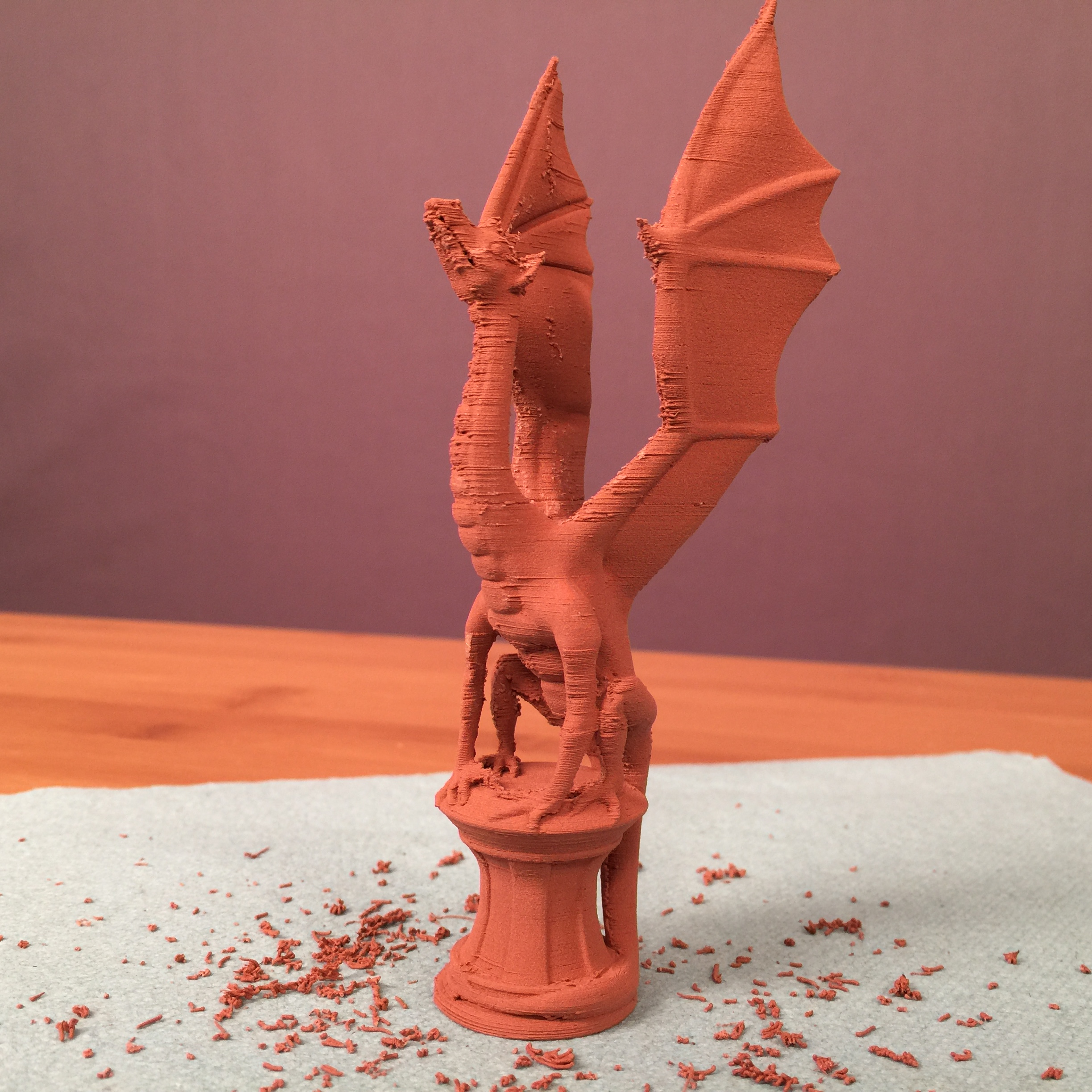

Aria the dragon by Louise Driggers printed in CopperFill on an Orion Delta printer
Aria the dragon by @Louise_Driggers printed in CopperFill on an Orion Delta printer from SeeMeCNC.
Sliced in CURA with 100micron layer height, 30/40 speed/feed, retraction dist 3mm, 90mm/s speed.
Artifacts and bits come right off with fingers. Slower speeds should reduce the excess.
Before letting it loose in the tumbler, thought I’d snap a few pics - might just break into pieces. Using brass Phillips screws as medium in a Lortone rotary tumbler.
That print looks pretty rough…
I think she’ll probably break in a tumbler, you might be better off using a Dremel. I sculpted in an open mouth, which while was interesting to do, was probably a design mistake for a model meant to be printed small.
Didn’t expect excellent quality using copperFill straight off the bed, tho I’m hopeful the tumbling process will smooth it out a bit.
Although it feels heavy, we’ll see how it fairs after a few hours of tumbling. Maybe it will survive.
So… This wasn’t 3d printed??
Yea, it was. 3D printed using copper PLA composite filament from ColorFabb.
