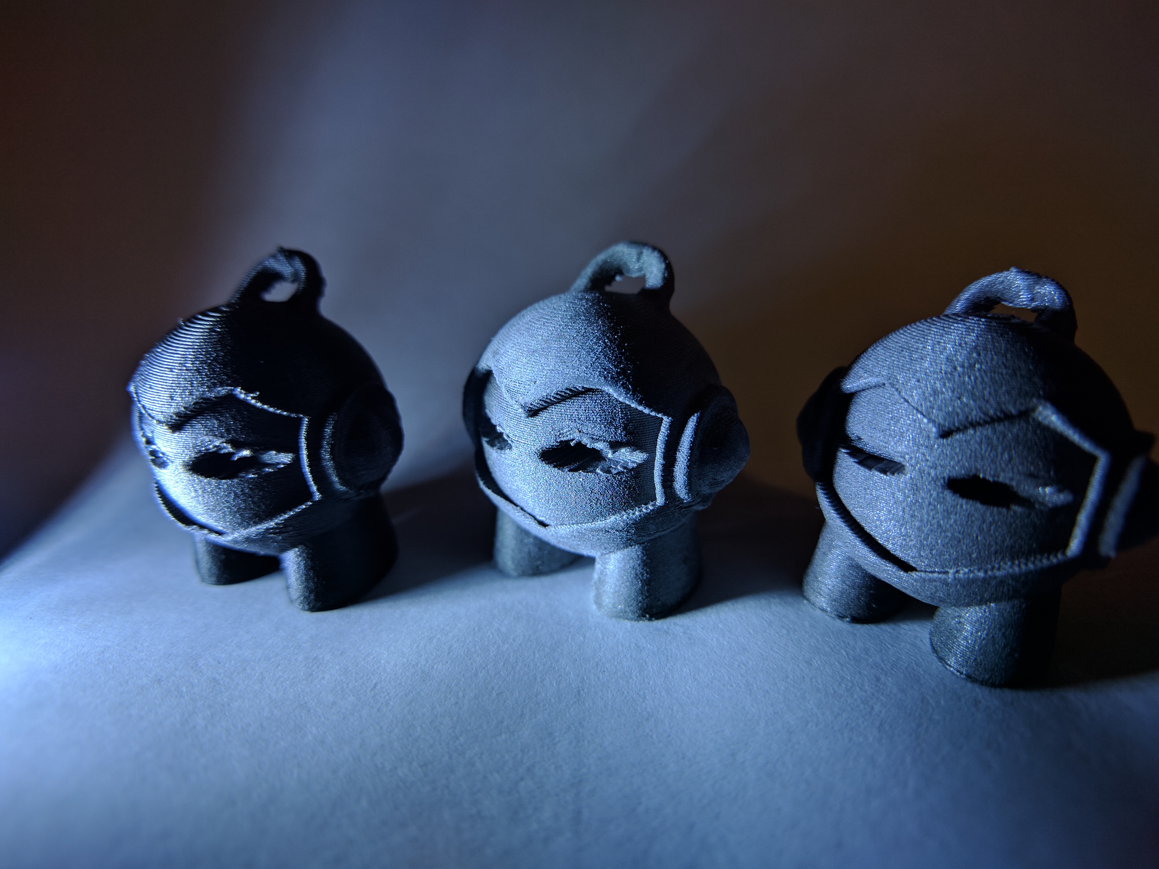

Army of Marvins. From left to right, carbon fiber PLA, stainless steel PLA,
Army of Marvins. From left to right, carbon fiber PLA, stainless steel PLA, and Iron PLA. I’m impressed with the quality of the filament. Once I sorted my blockage in the hotend, things came together nicely. Thanks again for those that helped me out!
