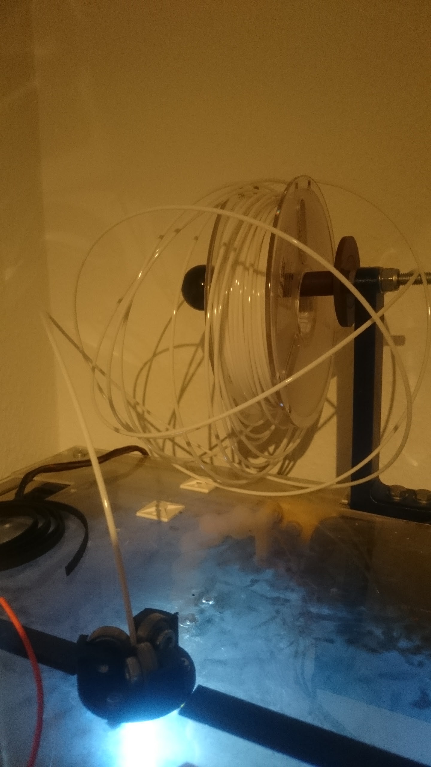

Arrrghh need to design a brake…
how about a sprag clutch, or does it have to be a braking system?
What printer is this the entry looks very interesting?
I used to have that problem when my filament spooled vertically. 10 and 15 pound spools would tip past the center of mass(cuz they’re never balanced axially) and then swing over, sometimes with enough force to rip the filament out of the extruder or jerk the extruder sideways on the axis. To fix that I used a one-way bearing to mount it and then it wouldnt swing back once it passed the center of mass over the top. So much easier to sit the spool horizontal on a lazy susan. No swinging, no unspooling, no muss, no fuss. Bearing plate is like $4 on mcmaster. 3d printed a cylinder that fit the center of the spool and matched the holes on the plate. 0 problems with the horizontal spool.
@Joshua_Taylor thats my homebrew printer. That is my thing Triangular Filament Guide found on #Thingiverse Triangular Filament Guide by Lord_Vader - Thingiverse
@Fred_U No needs to be a brake
or a new holder
How does one create a brake that will not interfere with filament dispensing? The filament would have to pass through a guide mounted on an arm with a slight bit of tension. As long as the pulling force from the extruder motor caused the arm to deflect, the brake is off. When the pulling force is relaxed, the arm spring pulls it out of alignment and applies the spool brake.
