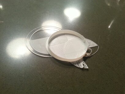

Arrrrgh!!! Can anyone help me diagnose this fault.
Arrrrgh!!! Can anyone help me diagnose this fault. The X axis overshoots on layer change and when traveling (when printing seems to be okay).
Anyone seem this before?
In using an Ultimaker 1.5.7 board and Marlin with auto levelling enabled. I’ve checked for a mechanical fault -there is no slipping.
I’ve checked the steeper drivers, they are set to 0.45(ish) volts over the POT. I’ve swapped the x/y drivers and the problem stayed. The x&z motors originally from another machine are hot to touch.
I’m banging my head against the wall. Any information will help.
Travel acceleration to high in firmware at a guess.
I turned the travel accel down to 1500mm but didn’t help. I then also turned the travel speed down to 60mm and the problem went away. I think the steeper drivers I bought for the ultimaker board are no good. Previously using a printrboard with integrated drivers I could travel at 200mm+ without a problem.
