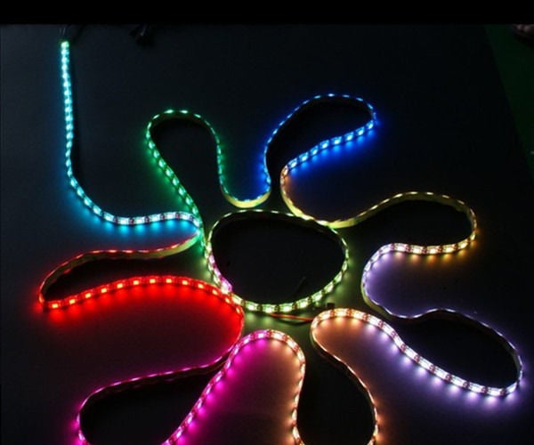

Note that the SK6822 is comparable to the WS2813B.
LED strips from different suppliers can have varying colour tones.
Also that many manufacturers/suppliers randomly switch between compatible WS and SK series chips.
SK6822 / WS2813Bs strips are more reliable than WS2812B type strips as one dead pixel doesn’t kill the downstream pixels.
I’d get a sample from your supplier and see how they look. (It seems that SK6822s need an external capacitor while WS2813Bs have it built in.)
