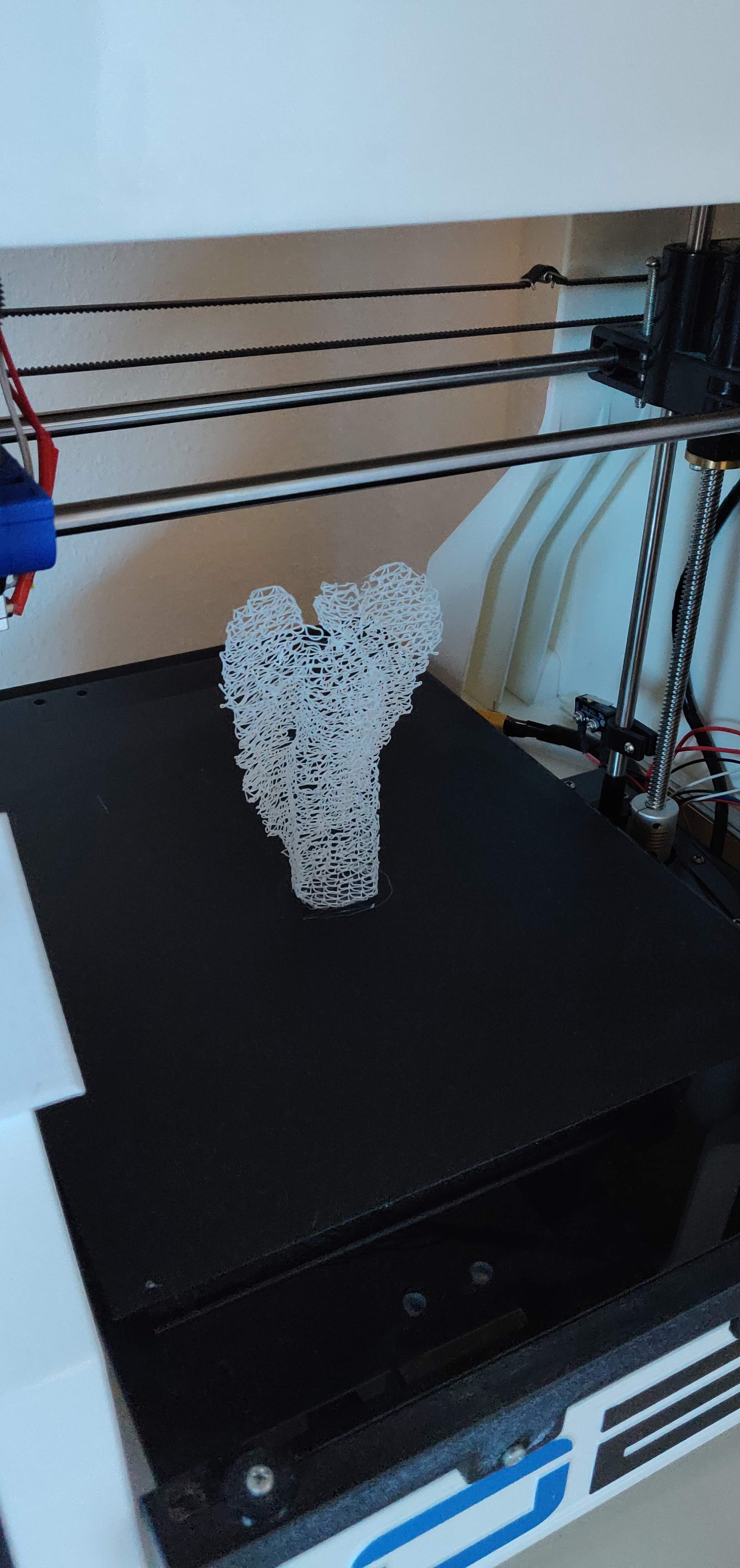

As described in an article in the German Make magazine, I gave Cura a try, using the wire frame printing. It is available in the experimental menu, it managed to print an angel using the default settings. Was anybody aware of this functionality?

Make also suggested to reduce the default as most printers do not have the 5mm clearance around the nozzle. The triangle vase looks interesting, I will try different settings to see how it performs.

@marc_kerger I used Cura just for slicing, then I saved the gcode to SD card and ran it on my Robo 3D after homing without an issue. I want to try with my Kossel next as I think it will perform better than a cartesian printer
