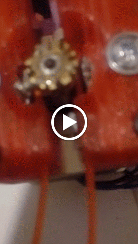

As mentioned earlyer, this is the version with catv jack housing. First and second attempt after finishing & mounting. The grip looks nice. will test with second ptfe tube to hotend. Impressions?
I guess the zip-tie is due to slightly larger gear diameter… I’m a correct?
Yap, also there is a bigger area in case the fillament is bended or wobbles
What’s the “flint” diameter? Should be easy enough to provide you with the corrected CAD files (if you want of course).
the one tested is 8.54mm. The one untested yet is 9.57. The new files would be ok. If not possible, i could do a rescale in slicer
@shauki still no video?
Scale only diameter, not height… i might be wrong at this hour
Yes, it’s unlikely to work this way. Special version for 8.54 mm ready (that was quick wasn’t it?).
