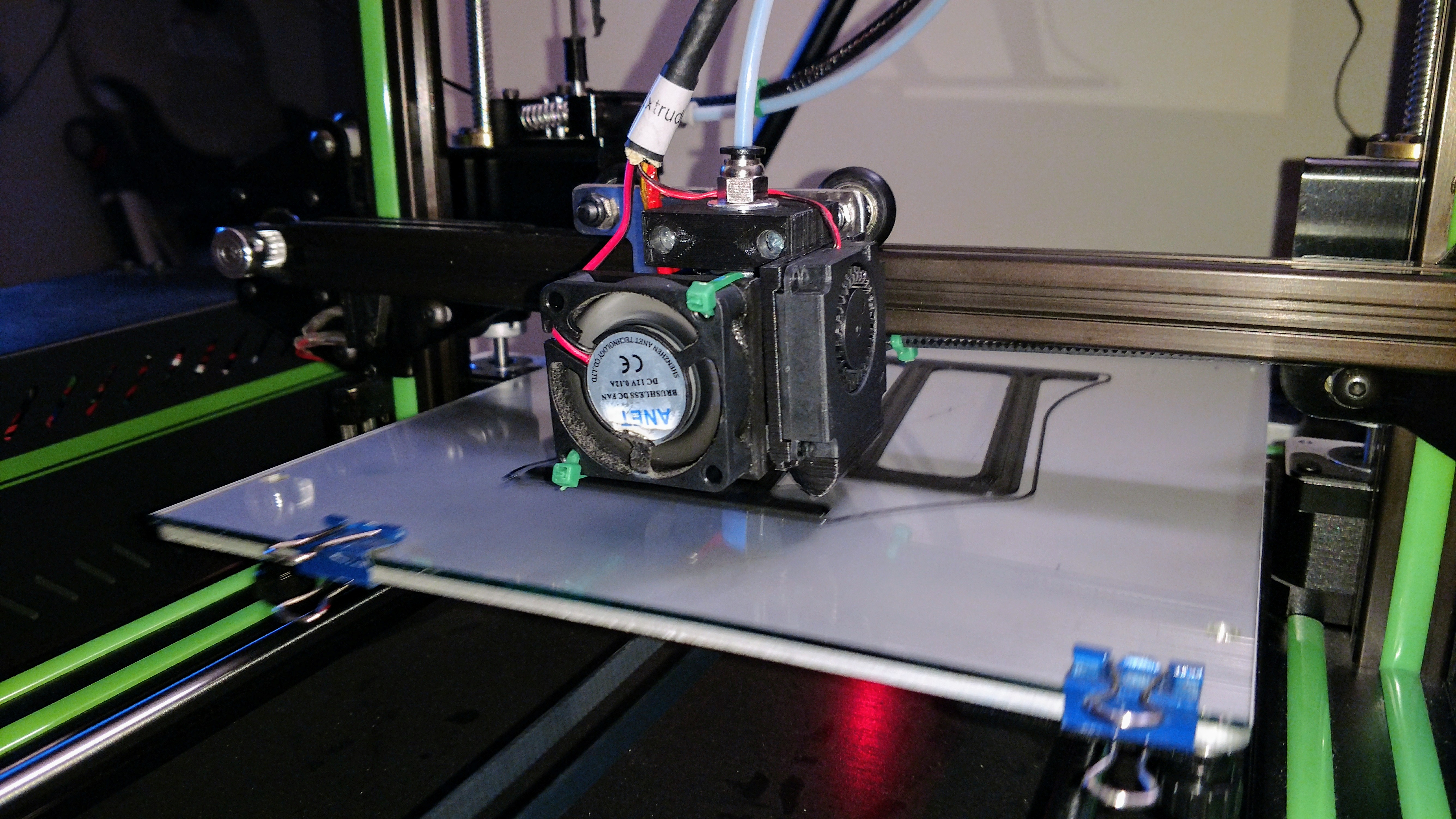

As of late I’ve been having problems with bed adhesion and I finally figured out the issue! Thank God… So as some of you may remember, I recently put on the Chinese knock off E3D V6 hot end and when I first put it on, it was working great. Then kinda out of the blue, parts weren’t sticking. Corners were coming up and it acted like maybe my part cooling fan was on. Obviously it wasn’t because I can see the fan on the side… What… The hell… I tried everything I could think of but parts still weren’t sticking. Well I needed to change my filament because my roll was low and Just by chance I stuck my hand UNDER the hot end and noticed something. A lot of air was blowing straight down… Apparently the adapter I printed for this new hot end has some holes that blow air straight down onto the bed! How did I fix this? I simply turned my hot end fan around. Now it’s sucking air through the heatsink and blowing it straight out the back. Now parts are sticking great again! What a headache though. If you’re having adhesion issues, make sure you know where any air is blowing to.

seems i didn’t read this proper - sorry Ü, my hotend fan is so low power that it probably wouldn’t do anything if it is blowing on the hotbed. (~0,6W)
