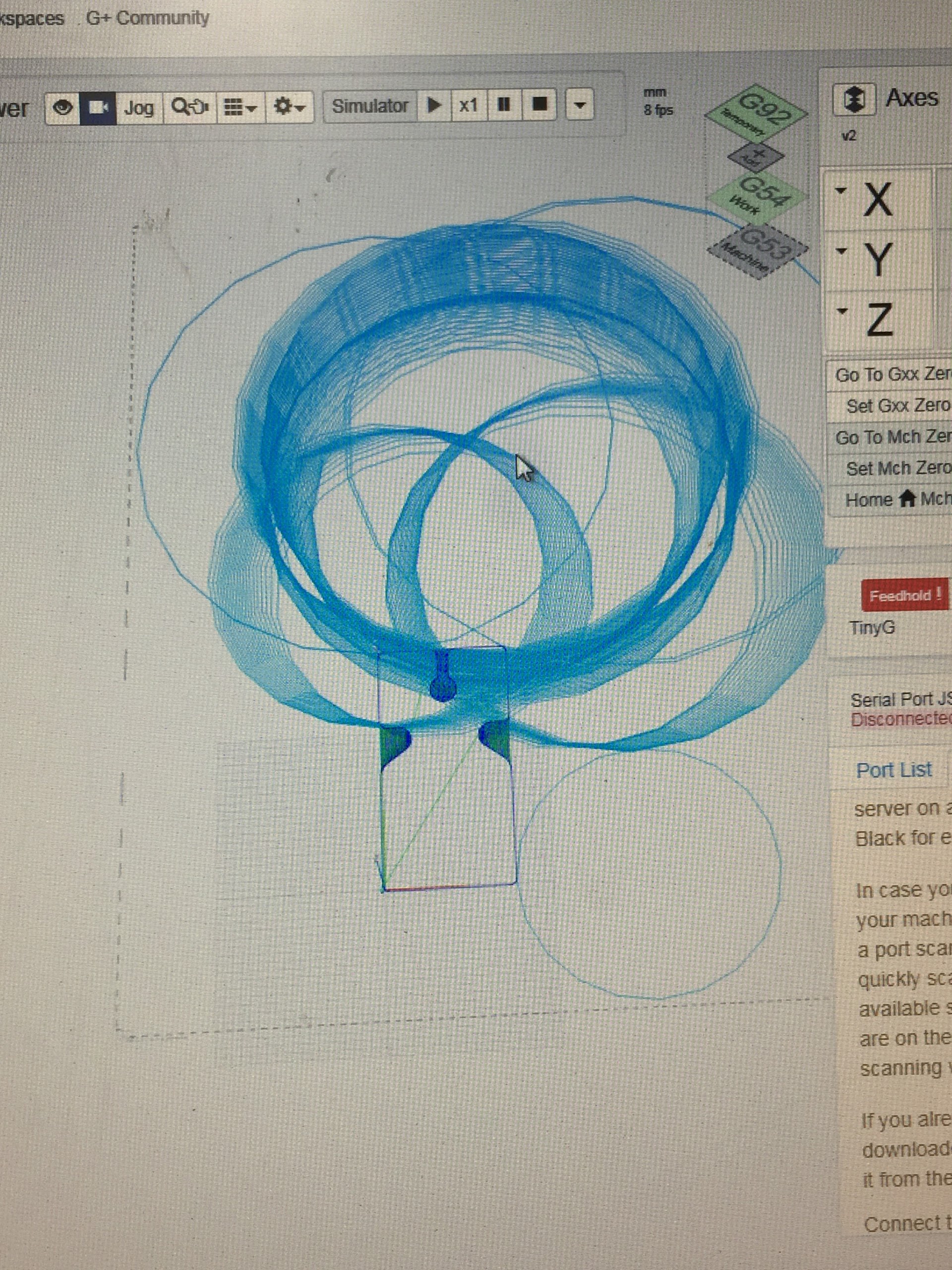

As pretty as it looks, it still wasn’t quiiiiite what I was looking for. Tried to transfer NC file from Fusion to CP.
Try my workspace at http://chilipeppr.com/dchote-tinyg
Agreed. Try Daniels workspace to see if the recent ijk are code fixes that rendering. Also another option is fusion let’s you generate gcode that has no g2 or g3 arcs.
I suspect that the problem is not with IJK absolute mode, but rather with a precision problem in the circle center calculation. The reason why I suspect that is because IJK absolute mode is not widely supported, and none of Fusion’s posts appear to use it.
That said, the fix is the same, as the IJK absolute patch include in Daniel’s workspace also fixed the precision bug. A minimal version of that patch, against chilipeppr master, can be found at https://github.com/MitchBradley/widget-3dviewer/tree/ijkabsolute

Does this look right? I got that by adding a GCode command G90.1 near the top of the file then using a workspace that supports IJK absolute mode. Which Fusion post did you use?
@Mitch_Bradley yes that is perfect!
