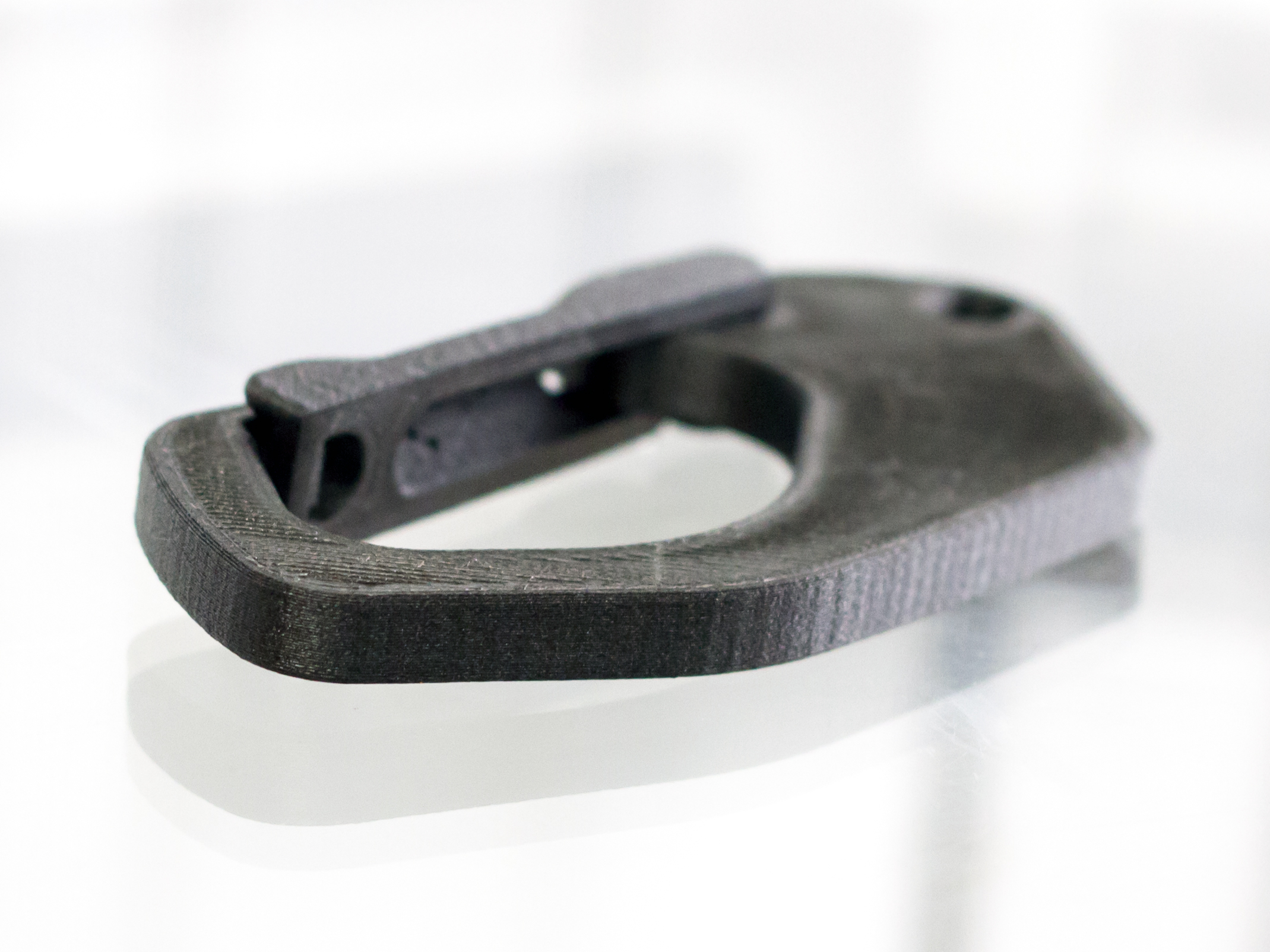

As promised, macro shots of the CF Nylon filament… strength tests will be performed next week.
Where did you get this filament from, if you don’t mind me asking?
You’re going to test it against non-CF nylon from the same manufacturer, right? It’s probably going to break more easily because the fibers are too short to add strength and only manage to create weak points in the base polymer around themselves.
That matte finish is nice though.
We’re going to do a load test on a bunch of different carabiners. I don’t have any raw nylon from this mfg yet, but we’ll get some. I do, however, know what material it is, and there are some nylon filaments that are very similar. The more interesting thing, in my opinion, will be how strong it is compared to other filaments.
But yes, the finish is excellent. Very nice.

The only thing that really matters is how it compares to filaments that are as similar as possible, but without the carbon fiber. CF is murder on the brass nozzles most people use, worse than metal-filled plastic according to the reports I’ve heard. If this filament isn’t stronger than the same base polymer without the CF, then the only reason to print it is for aesthetics (much like metal-fill).
How are you going to test the strength of the part? I guess you will print a set of carabiners, then add hanging weights to each of them until they fail, and take the average…?

We have a block and tackle with a 7:1 ratio and a rather precise force tester. Haven’t figured out the exact mounting yet, but we’ll attach the carabiner and apply load until it breaks and/or bends enough to come apart.
