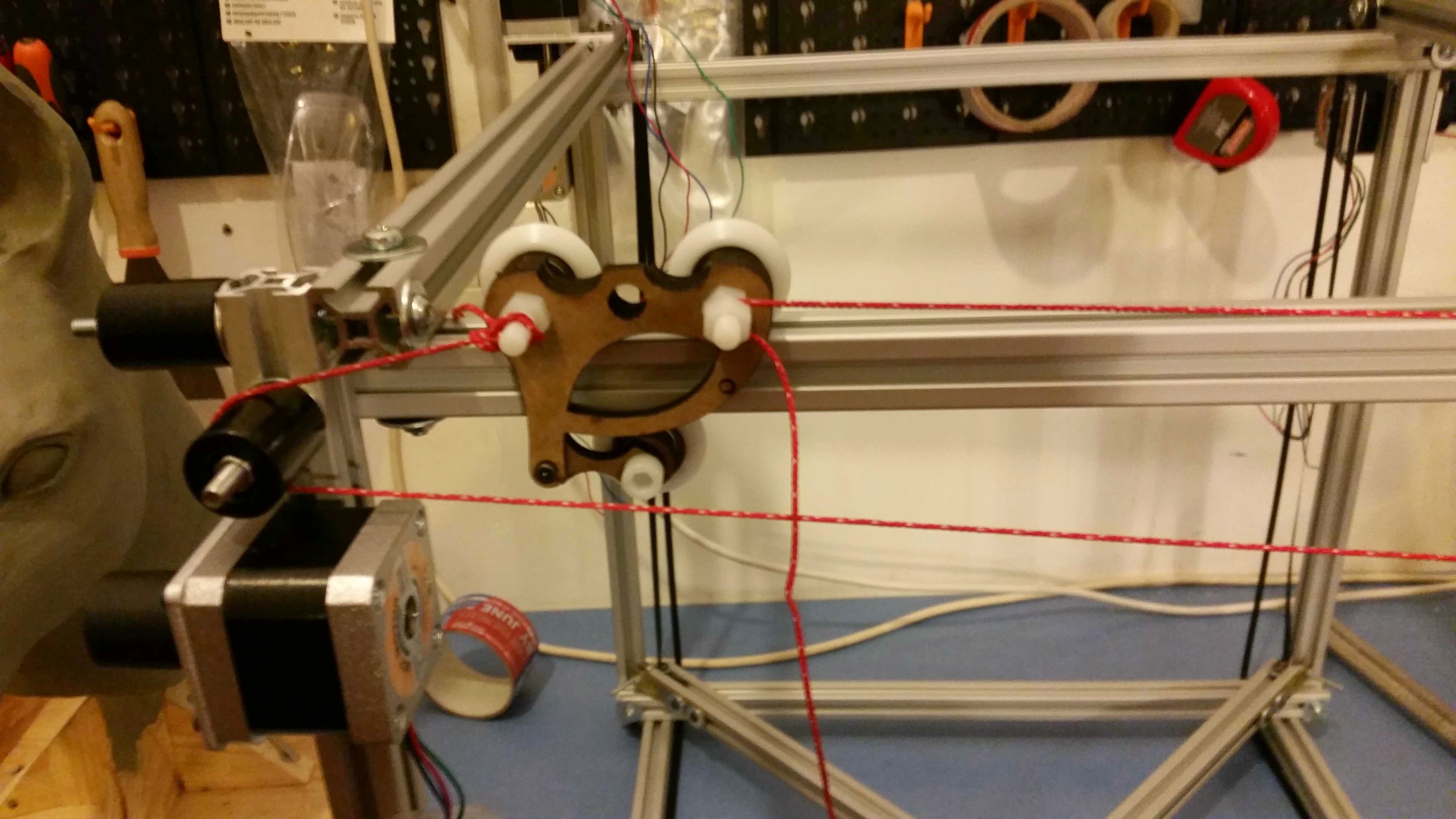

need modify little my carriage design or add support for belt/cord on rod.
i mount carriage for see if Shauki pulley work but currently photo show a not correct mount geomerty.
start to close frame (before fix manualy bolt and nut) now add nylock bolt and confirm you can kick this frame without any issue amazing solid, real good solution
