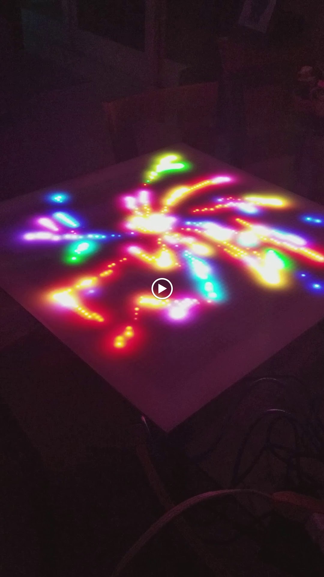

As requested, code for the 64 x 64 matrix. I added some comments but my coding style would not get me far except in a code obfuscation competition. buyer beware, you get what you pay for.
This is ever evolving, but this is today’s version.

Nice. Now, I gotta ask: what are using for a 64x64 matrix? Is it one shot, or smaller tiled matrices? How big is it?
Also, first time I hear about https://github.com/Jorgen-VikingGod/LEDMatrix Nice to see it exists.
to me, one of the best thing about FASTled is how it is all based on byte sized elemets and you can use the rollover of a byte to your advantage and not have to keep score or worry about overflow
@Marc_MERLIN prior to this I used strips, mounted side by side in a zigzag pattern, with lots of soldering and cursing. With this one I switched to a matrix panel approach. So, this is made from a bunch (16) of16 x 16 matrix panels. I wire them in pairs making effectively a 16 x 32 panel and drive each pair with one of the output lines from the Teensy 3.2/Octo adaptor setup. LEDMatrix thinks it is outputting to a single big 64 by 64 matrix (zigzg) but the function “spititout” maps that into the 8 panels. The panels are easily found on Ebay for reasonable prices. They may be marketed as bendable or flexible.
@Mark_Estes cool I was wondering if you were indeed using a bunch of 16x16 panels wired together. Nice.
