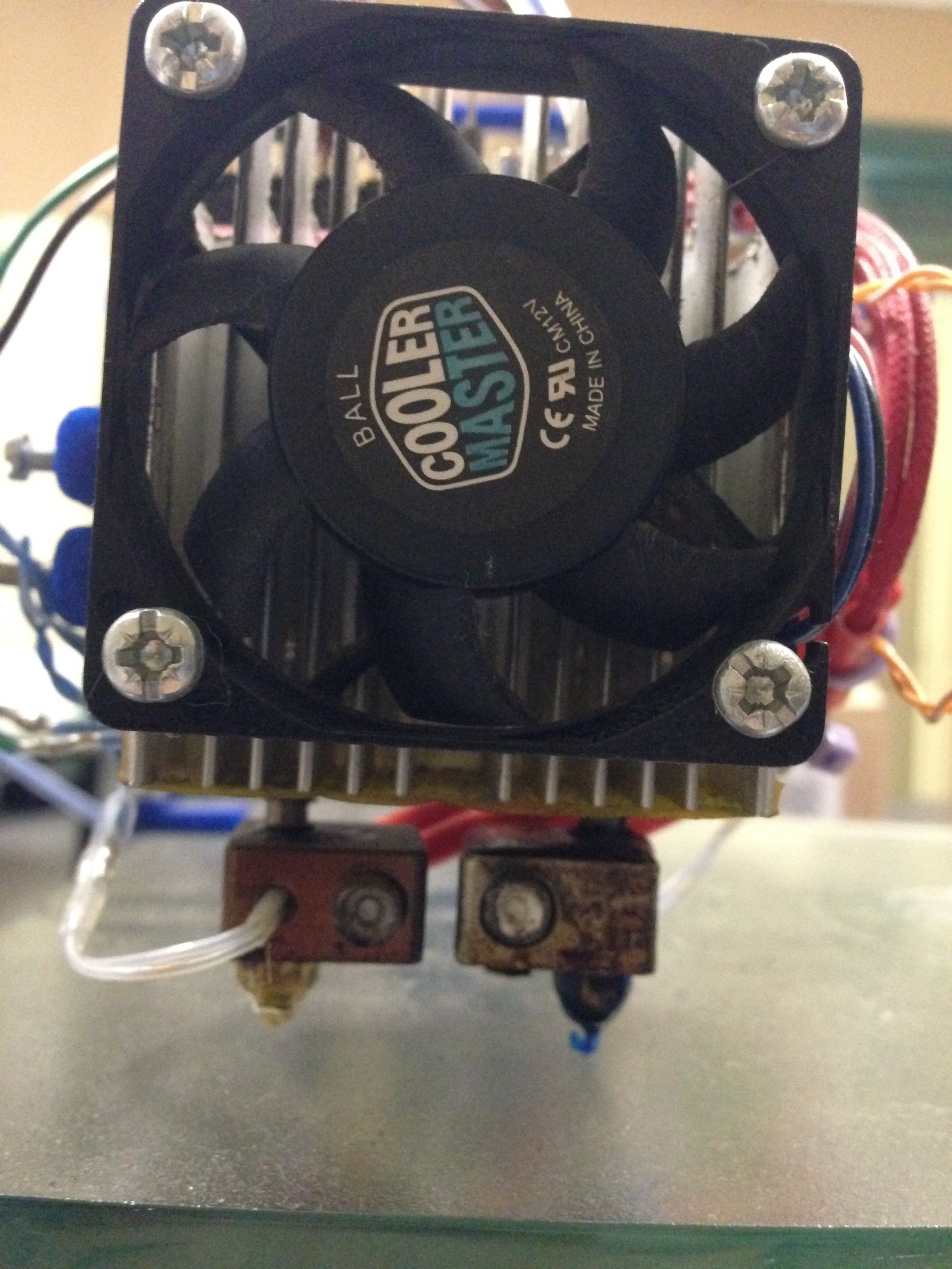

As requested here’s a photo album of my smartrap builds its rather customized. Build plate is 10mm glass at the time belts weren’t std. I nixed the auto leveling and if you look at the bed I shimmed the bed with blue tape to level it. The print heads need to be adjusted to be level with the bed so if you look at the front mount it’s got a smiley face so it can twist till level. I had some trouble with twisting on the axiz.

As far a print quality goes if you look at the pics there is a pink part on the back of the front mount that was printed on this printer you can zoom in quite close to see the print quality is pretty good.
