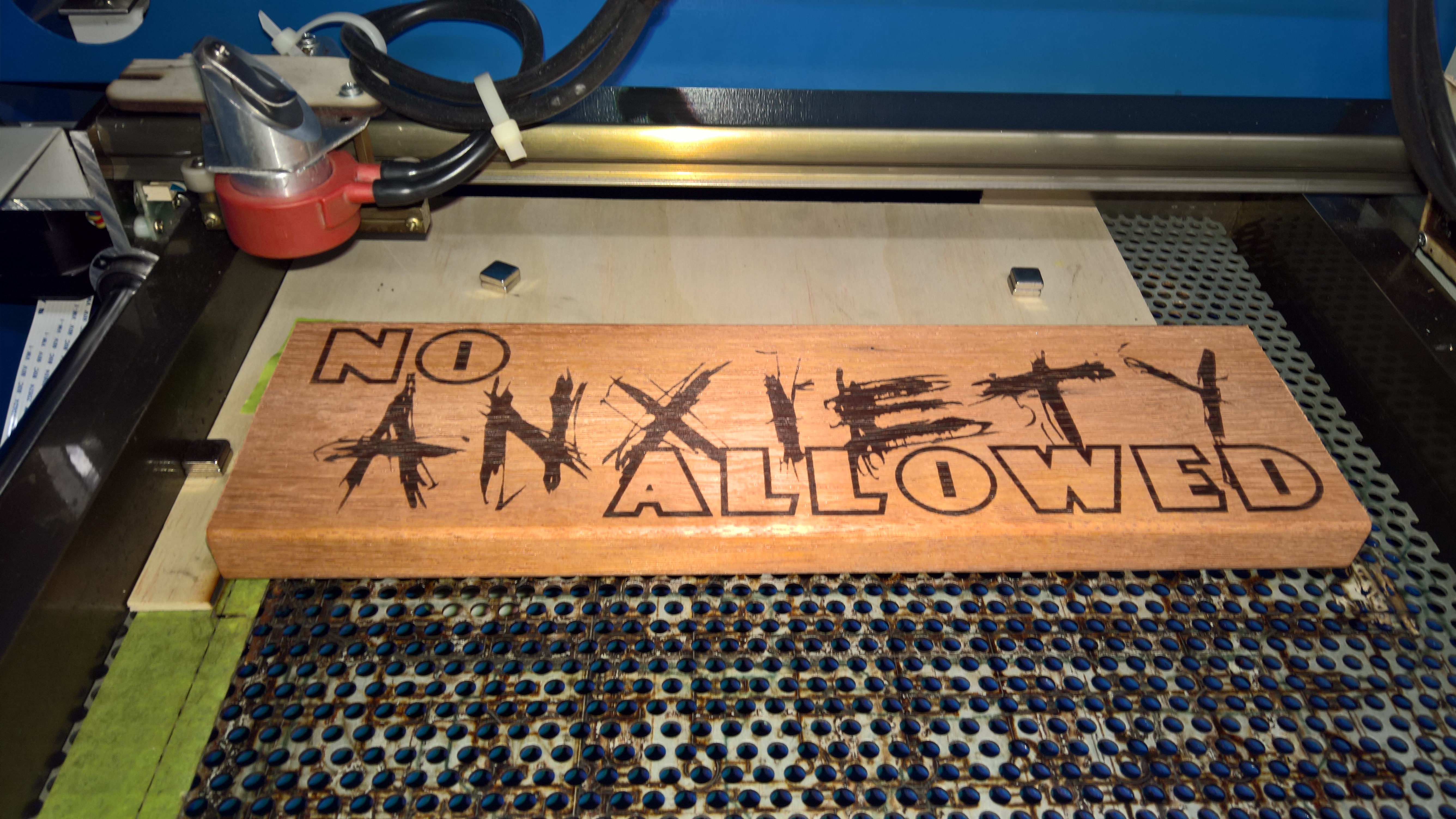

As someone who has suffered from anxiety for most of my life, I’ve decided it is not welcome in my house anymore.
4 passes, 1st pass was 4mA @ 350mm/s @ 5 pixel steps. Barely even marked the surface.
2nd, 3rd, 4th pass was 10mA @ 350mm/s @ 5 pixel steps.
Even after all that, the engrave still ends up being only about 0.5mm (or less) deep. Merbau hardwood is literally very hard.
#noanxietyallowed #merbau

Nice sign. Love that Merbau!

Next time it’s operational I’m going to burn a copy of your sign for inspiration. Is that “Anxiety” text your handiwork, or is it a font?

The Anxiety text is actually a font I have downloaded somewhere a while back. It’s called XXII Scratch. The other font was something I randomly chose, turned white, added a 3mm border. Can’t remember which font it is, but seemed nice & blocky.
