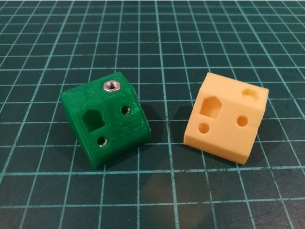

As suggested in the Facebook group, here´s a simple calibration cube with some different pockets for M3 nuts similar to those used in the OpenRC F1.
Should only take som 15-20 minutes to print and may very well be worth the effort as printing the entire car only to find out the nuts won´t fit can be pretty disheartening.

I actually like when nuts fit very tight, I heat them and slide in the hole.
Fit perfectly when printed on my Original Prusa I3 Mk2s.
