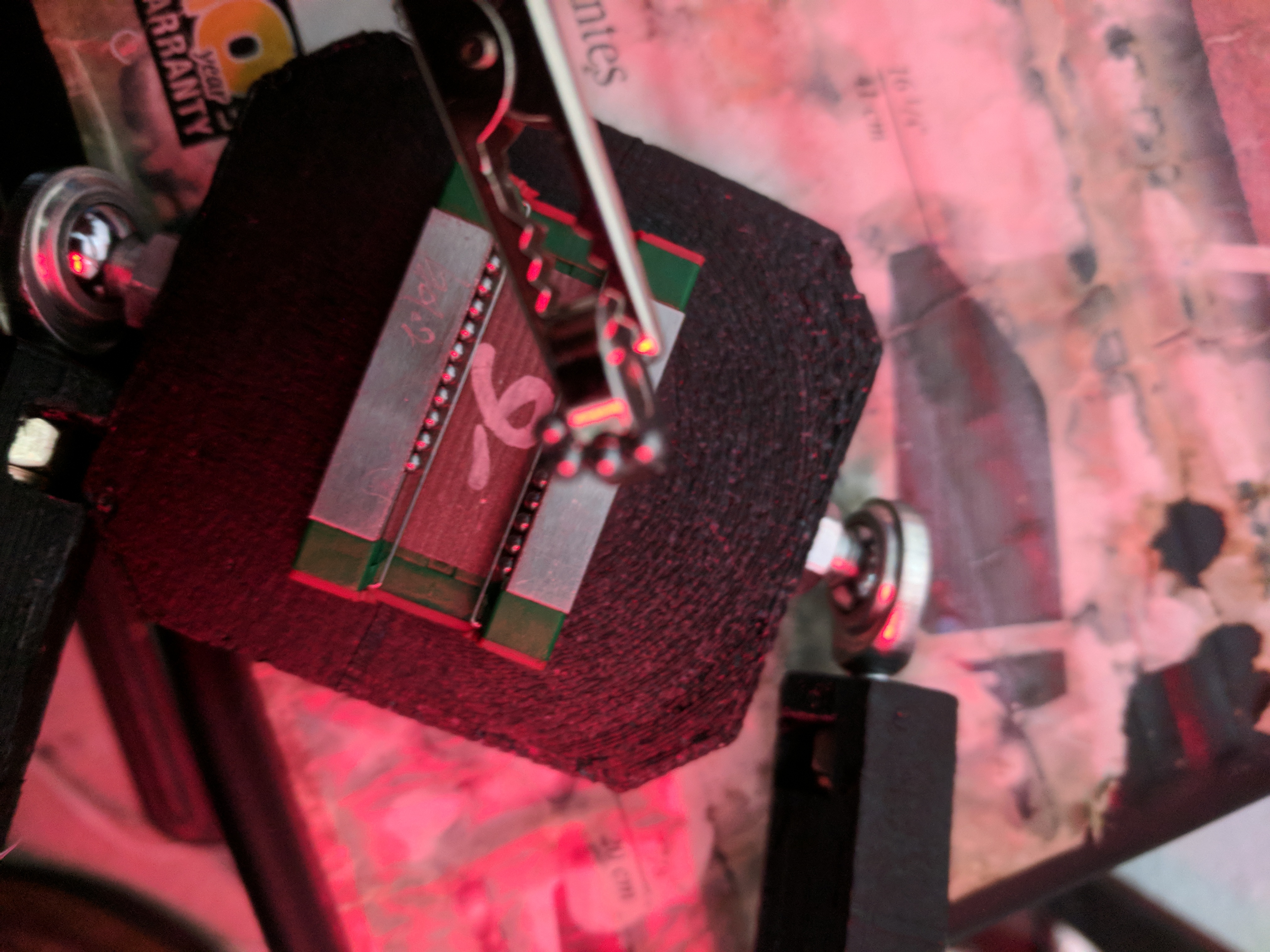

Assembly has come to a stop… ball bearings keep escaping from the linear rail carriages​:disappointed_relieved::disappointed_relieved::disappointed_relieved: any tips or tricks for me?

You can re-feed the balls. Clean the balls of any dirt and contaminants, and the ball tracks on the car if any dirt got in there. Make sure to measure the ball size with a caliper now, in case you need to order more. I think hey are 2.5mm, it check for yourself.
Slide the car into the rail so most of the car’s ball track is on the rail but leave some of it out, trying to be careful not to eject any more in the process. Push feed in the loose balls into the exposed gap until all of them are in there. It’s OK to have a gap in the ball track that looks like it’s one ball wide, that seems normal. Two or more might mean you lost some and should order some.
