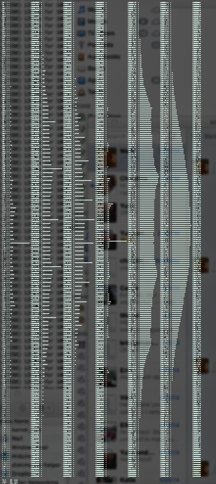

This led to some problems. The first one was that I only used a run of a couple million 3d values to determine the min/max ranges, then used that for the 1d and 2d ranges as well. What this meant was that my scaling was flat out wrong for 1d/2d, and also it was enough off with the 3d noise that sometimes values would wrap when they shouldn’t.
So - these are now fixed - and you can see the distributions of the output of the inoise functions below.
