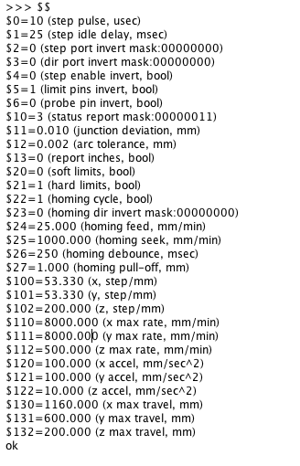

what are your default grbl settings?
@Walter_K_opaque in case you need type $$ while connected to the board and it will display your current settings
: $0=10
: $1=25
: $2=0
: $3=0
: $4=0
: $5=1
: $6=0
: $10=0
: $11=0.010
: $12=0.002
: $13=0
: $20=0
: $21=1
: $22=1
: $23=3
: $24=500.000
: $25=1000.000
: $26=250
: $27=3.000
: $30=1000
: $31=0
: $32=0
: $100=106.670
: $101=106.670
: $102=250.000
: $110=50000.000
: $111=50000.000
: $112=500.000
: $120=100.000
: $121=100.000
: $122=10.000
: $130=1160.000
: $131=600.000
: $132=200.000
: ok

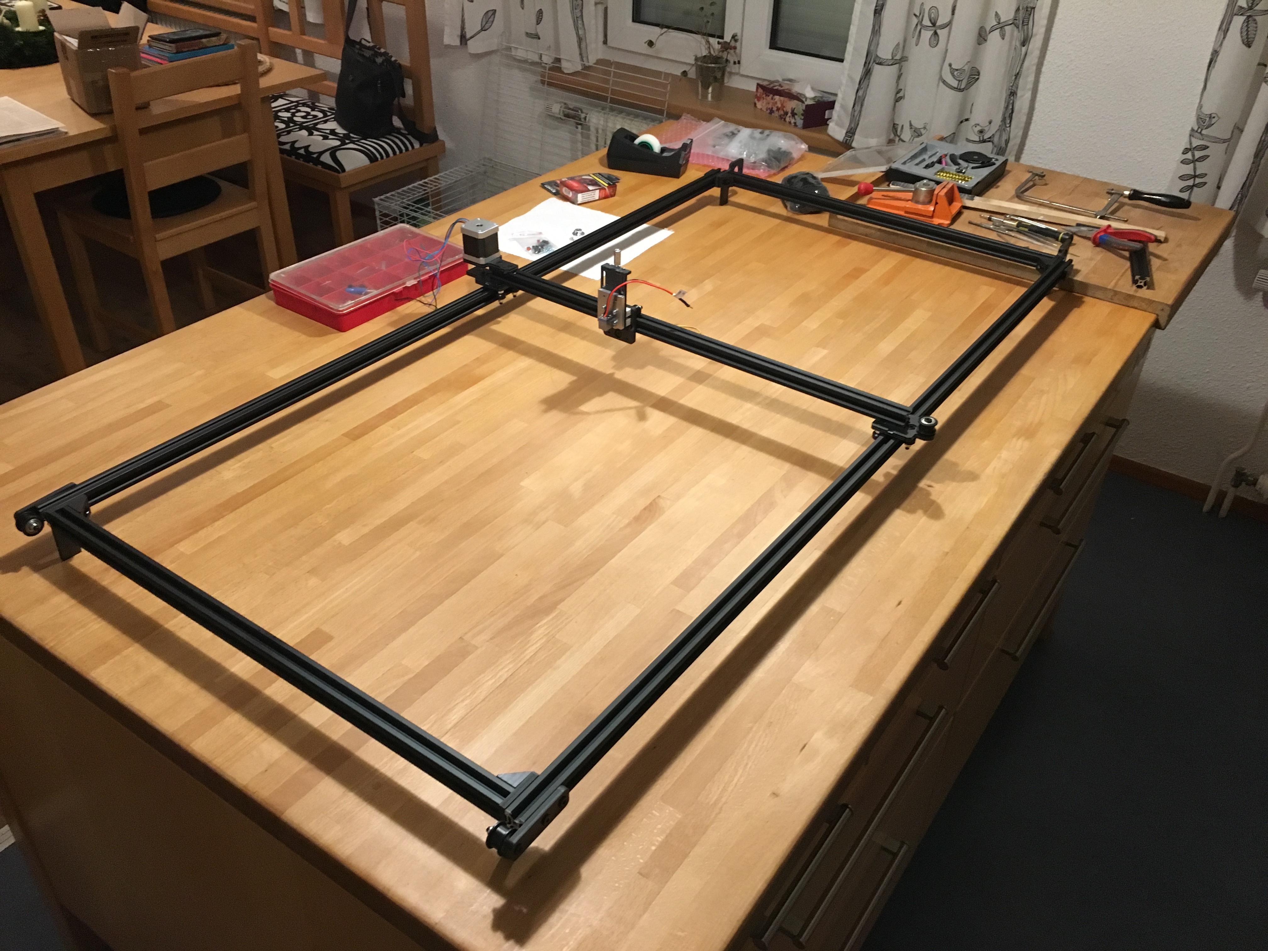

nema17, with GT2 30tooth pulley

I have an old screenshot so I can take a look what $120 and $121 stands for (acceleration). What do you prefer?
+Peter van der Walt what was the issue with homing?

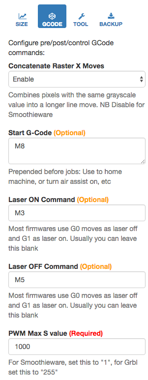

So I have to Update grbl. $32=1 my laser will not start.
I have no homing problems. All endswitches are serial connected and are NC.
Thanks for the acceleration tips. Now it works faster. With $32=1 I can´t start my laser driver. No I will use $32=0 and M3/M5. Any tips?

no, Openbuild 20x20 V-Slot

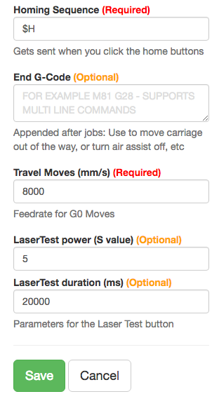

Laser Test Button won’t work here. How can I make this with a Macro Button.
