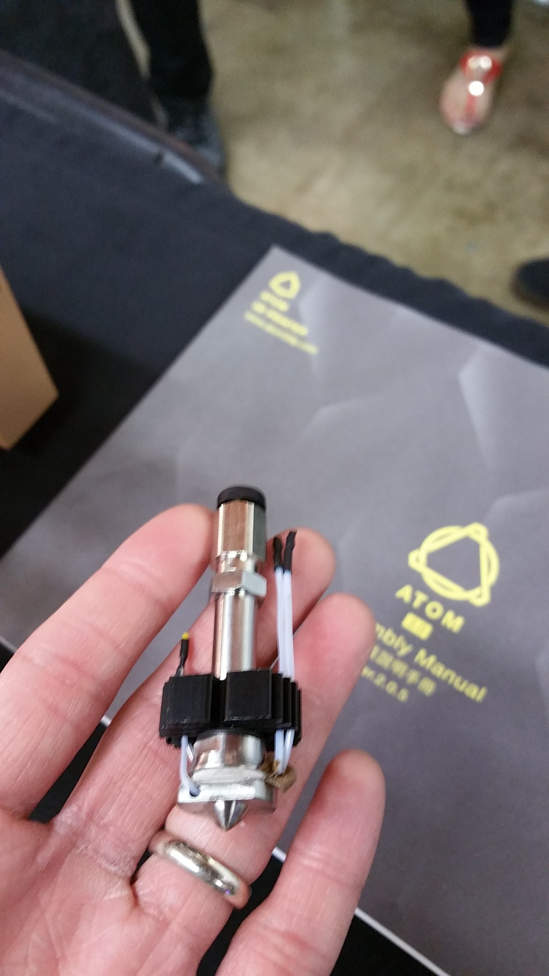

Atom 2.0 delta hotend. Looks very light and print sample was really impressive too.
Atom 2.0 delta hotend. Looks very light and print sample was really impressive too. $1,700 for the kit… I asked if I can buy the hotend only they just laugh and say no… :confused:

than nozzle looks permanently fused to them hotend. why do such a thing? You’ll never be able to use different nozzle sizes it nozzle materials or exchange a nozzle worn out from abrasive filament types.
Ya it didn’t make sense to my why certain part especially the important bit is not sold separately on its own… perhaps they just wouldn’t like to see their hotend on some other machine…
Alumina ceramic disk heater?

PTFE all the way into the nozzle. Hmmm. No high temp filaments in that one then.

Only offered in 0.4mm at that. I never changed nozzles much until this year, but now that I am, I don’t see going with a fixed nozzle. Or one that has PTFE touching the hot end - they are using PTFE to insulate the thermistor.
