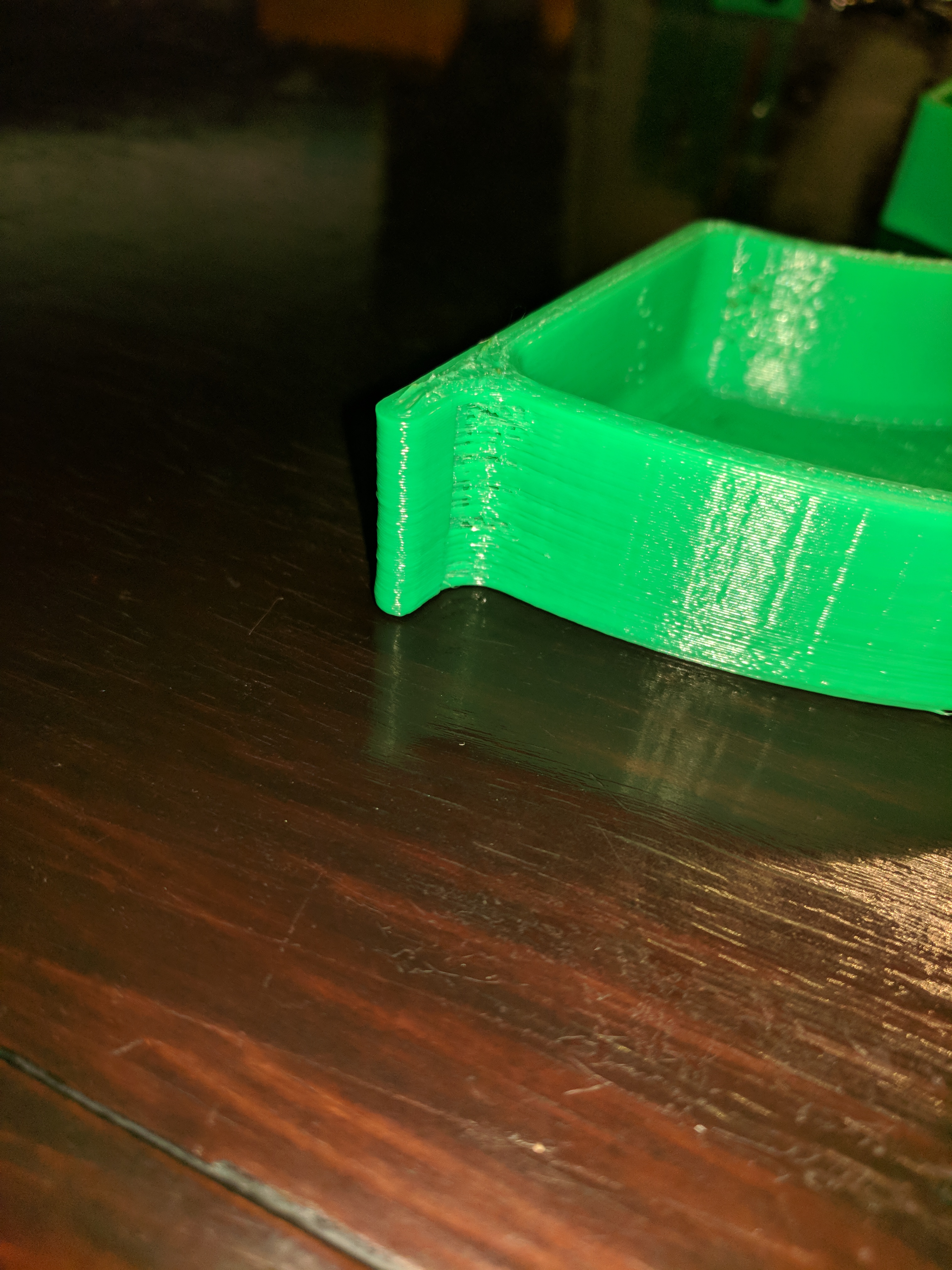

Latest print:
It’s that stringing in the corner? Did it just flick out?
Relatedly I’ve got a few bits of foam packing sheets from stuff that I tape together to make a ghetto enclosure, seemed to help on long prints I was running
@Mr_Bonce not stringing, a shortage of plastic in that bend. Printing with slower speed and acceleration, at present. Will see.
