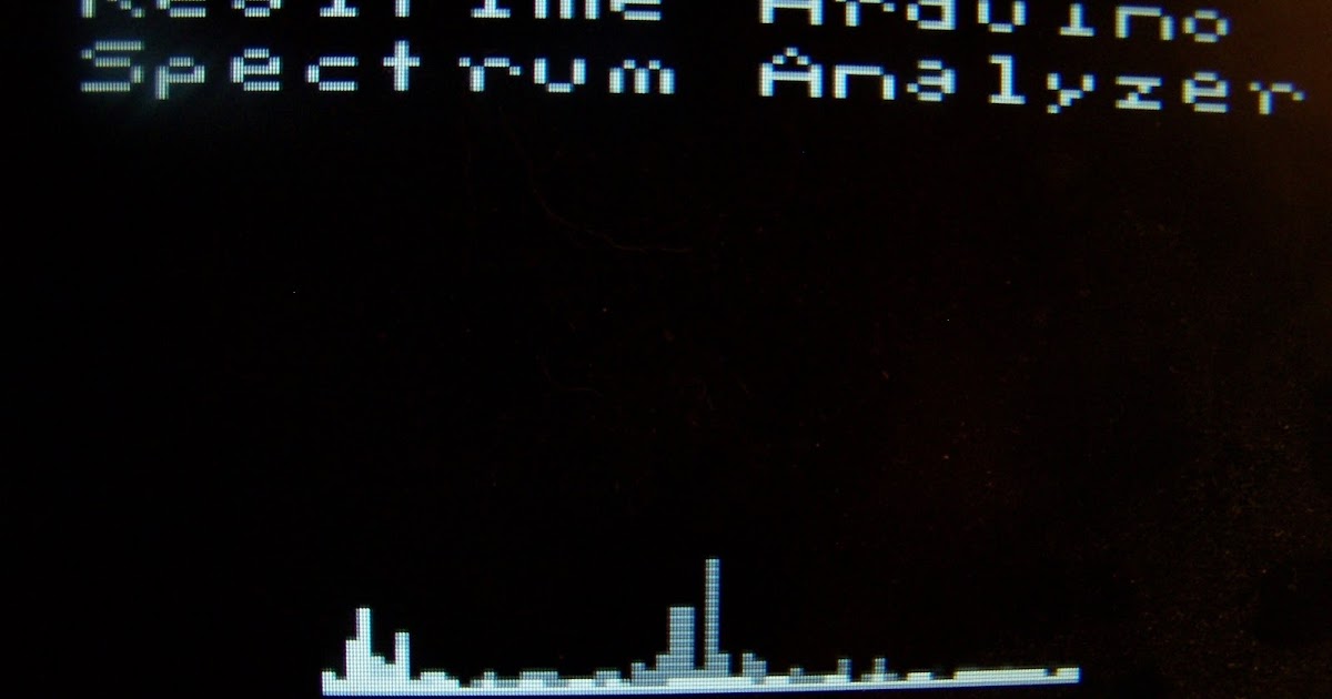

I have a MSGEQ7 but why limit yourself to 7 bands? Need to find the time to implement but I saw an example of 128 bands somewhere I think…
By fiddling with the offsets? On the surface a nice idea but people who propose these ideas tend to overlook the fixed Q of the filters. You’ll get so much overlap to be meaningless. If you really want more bands it would be far more profitable to use a beefy controller that can run real time FFTs.

My intention is to do fast FFTs and 128 bands is far outside of what I both have the clock to do and way overkill. However, I would like something like 24 bands. I also just want real sound interactivity and no one to really analyze it for accuracy.
I honestly have not messed around with it much because I have heard of so much trouble with the noise with using a mic… I don’t want to push a audio line it but rather be "listen"ing
Okay, I thought you were talking about using multiple msgeq7s at first, so we were at cross purposes there. FFTs are certainly desirable but then you’d probably have to leave arduino IDE behind if you wanted to pull in some code? Obviously it’s waaaay outside the realms of normal arduino land, teensy aside.
perhaps you missed the link… its an audio sheild for a teensy… plenty of processing for FFTs
Gah, I know… I’m talking about what IDE you’re programming the teensy sigh.
, sorry teensy WITH, ipad autocorrect getting carried away.
Been meaning to try it out with a pro328 and then just I2C the values to the other one pushing the LEDs… just need to expand time a bit to figure out when to do that : )
I don’t think id call an 8 bit fft hack to be superior to using an msgeq7… Would be a horrific shackle to performance and accuracy.
