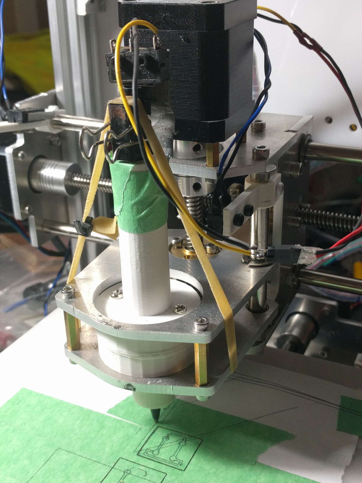

I am reluctant to dive straight into whirring sharp blades while I am still familiarising myself withe CNC world, so I have rigged up a 3-D printed pen holder as a spindle motor replacement. Thanks to your previous assistance I have been able to get ChiliPeppr (CP) to draw the desired path that would cut a PCB “etch” from an Eagle design (also very simple, two resistors and some track). This might look a little whacky but until I have got Auto Levelling working I am postponing and real milling.

My understanding and skills have improved since last asking a question, but this one is really bugging me now, I feel I am so close. So any assistance will be greatly appreciated. I include a photo of my Heath Robinson gizmo to show I have also mastered how to include a photo and a screen grab. :slight_smile:

This is the machine/engraver partly built, and I bought from a Chinese manufacturer in 2017. A sturdy little machine and should good for my purposes. I have two limits switches, Max and Min on each of the Xaxis & Yaxis input pins (Arduino Pins: 9&10 respectively) and Z Max limit connected to Pin12 SpnEn (not ZAxis as marked in the Protoneer Board, pin 11 is now used as SpnEn as it is capable of PWM and 12 is not). The position for the start of the scan is achieved by jogging to a paper thickness off the PCB and the CP used to Zero out the position.
