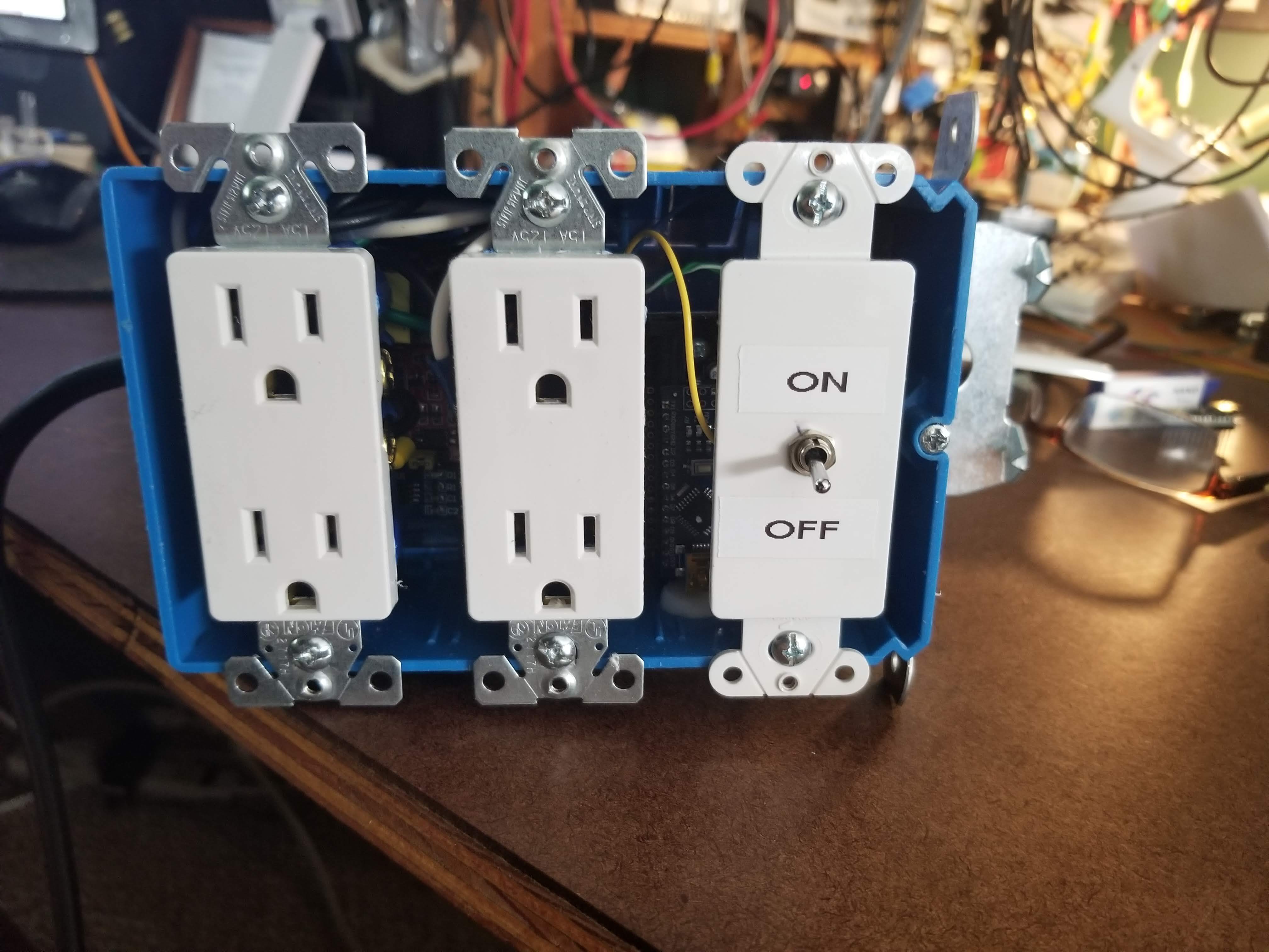

Here is my reworked version of the vac control.
Bigger box more features easier to make
After using the proto I realized that it would be nice to turn on another device besides the vacuum, like my drill press light.
  • 4 way box for more room and easy wall mounting
  • Aux plug always on
  • Tool plug (where current is measured)
  • Light plug (comes on with tool)
  • Vacuum plug (comes on with tool)
  • Acrylic sub-plate for easier assy and some isolation
  • All amazon and big box store parts
  • Easy usb port access for programming
  • Nano in socket for easy replacement
  • Large capacity AC cord and gland
Video, docs & code coming next
Looks like this but yours has a few more whistles and bells
That is an AC relay that is controlled by a digital signal. It has no current sense or smarts!
My controller controls 2 outlets based on the current drawn from a 3rd.
