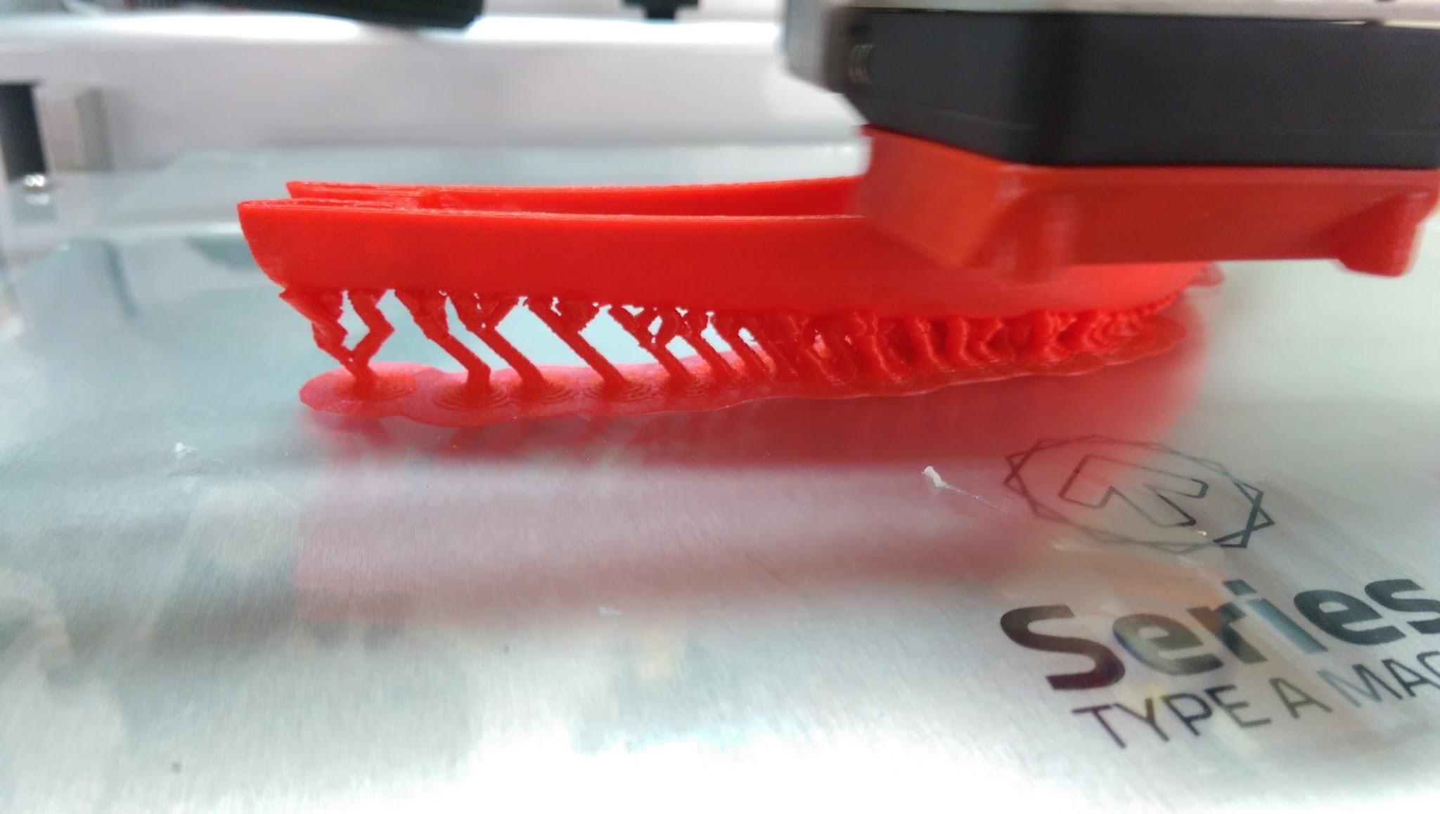

@Autodesk_123D1 @meshmixer support structures, when they work, are really cool…because they have a circular base, I have literally never had them peel up from the print bed because there is no small 90 degree wedge/corner for them to “start” the peeling process. They rock!
You really have to have your printer really tuned in, to print the thin pillars MM creates, though.
What printer is that
The printer is the @Type_A_Machines1 Series 1 2014 printer, printing with “victory” red PLA, 200 micron layer height.
