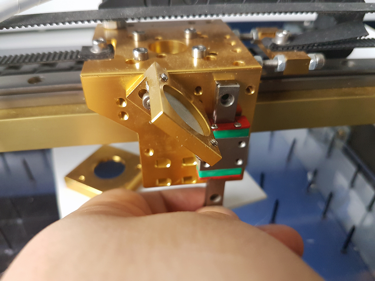

As seen in the pictures below, my 3rd mirror is mounted at top, the movable part will be below this one, with a bl-touch sensor or limit switch sensing the material.
With this parts, it will have a travel of 50mm

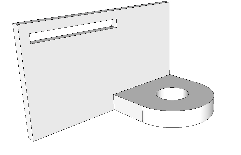

Prototype of the moving part in the printer now, the round hole holds the lead screw, and the slot is to align the lens left<->right if needed.

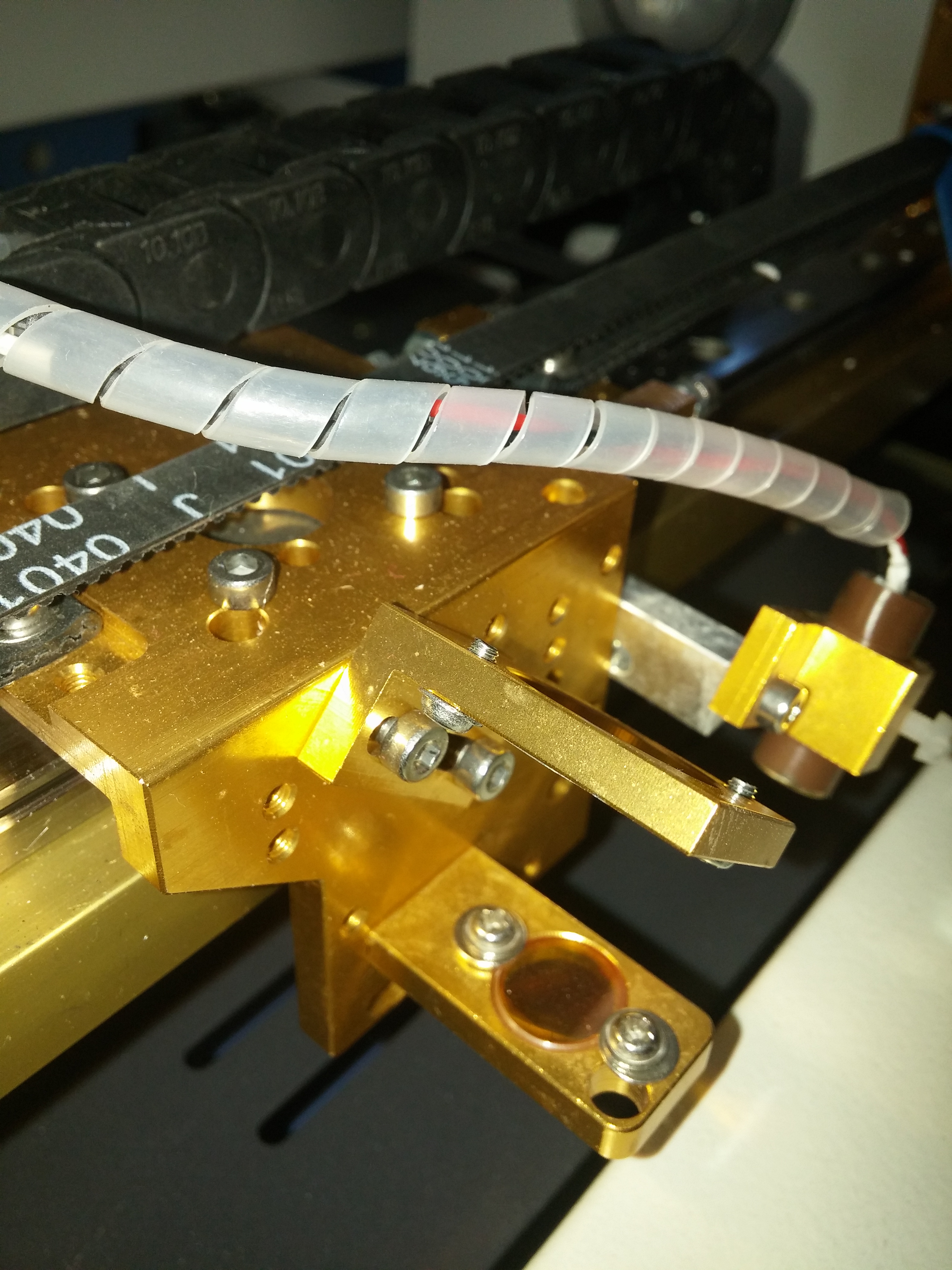

@donkjr This version of K40D doesnt have a “head”, its just a piece of metal holding the lens. See pic.
I´m doing it similar this time, but adding laser pointer, air assist and a fan to the head too. So i have to design it from zero, but i have been running with my own design movable head for 6 months already so i gained some knowledge how to optimize it :slight_smile:

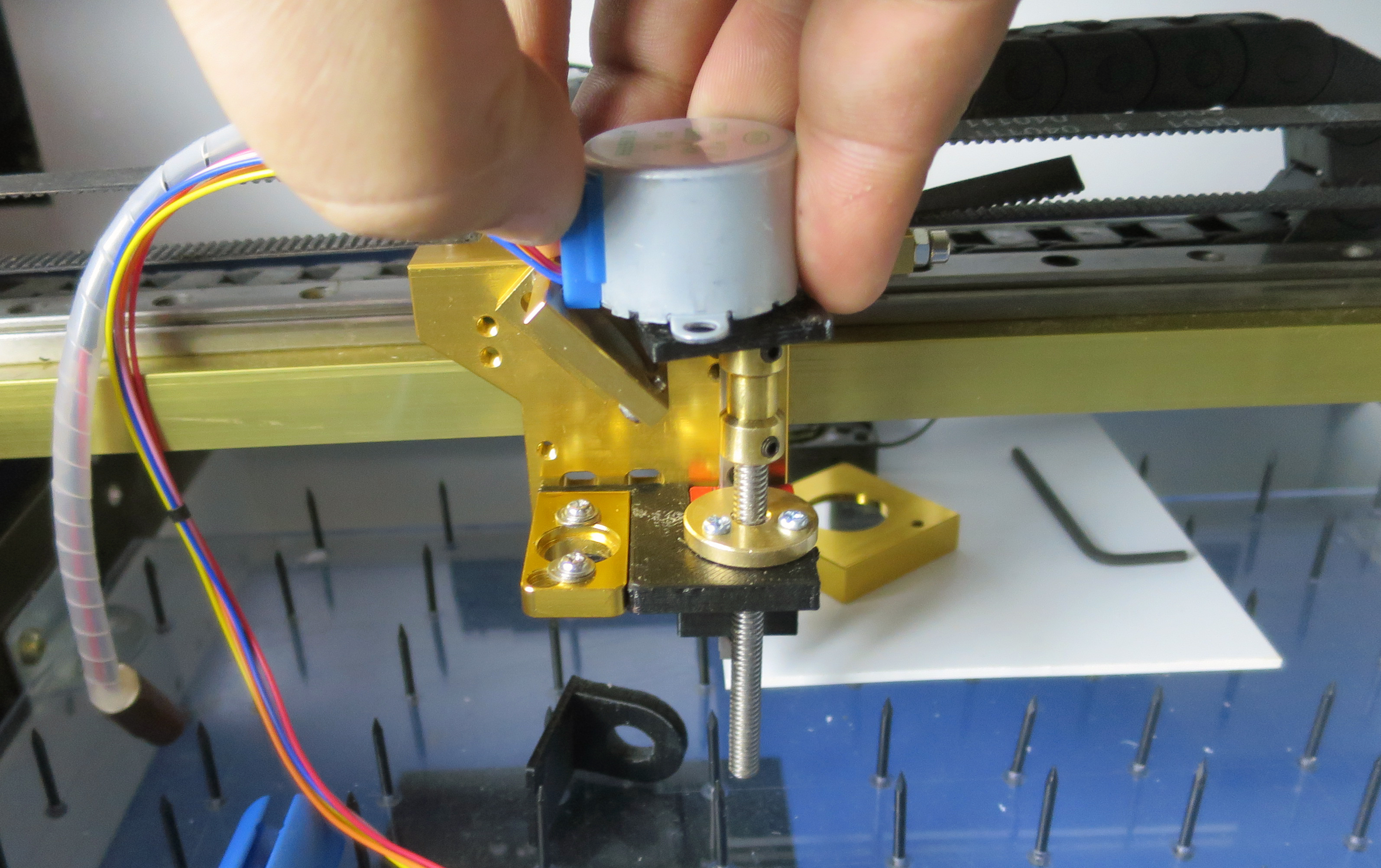

Version 0.01 :stuck_out_tongue:
Re-using the original mount to get everything correct before i make one from copper or aluminium.
Step 1 is proof-of-concept, get the darn thing to work :slight_smile:
Black part is 3D-printed, pretty solid and no wobble, but will not use it in the final version :slight_smile:
Time to make the stepper mounting.
So the motor should move the black part that’s attached to the lense holder? Is that going to move up and down perpendicular?
Yeah, motor is moving the black piece up/down. The gold part holding the lens will be in a solid part with the black in final version.
Thats why i´m using the small slider, to always have it 100% vertical aligned.
Mirror is always still, never moves.
To the right of the trapezoidal screw i´ll mount the BL-touch sensor and red dot.
Air-assist will be a pipe from behind/below the “laser head”.
