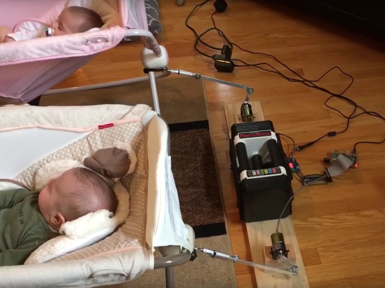

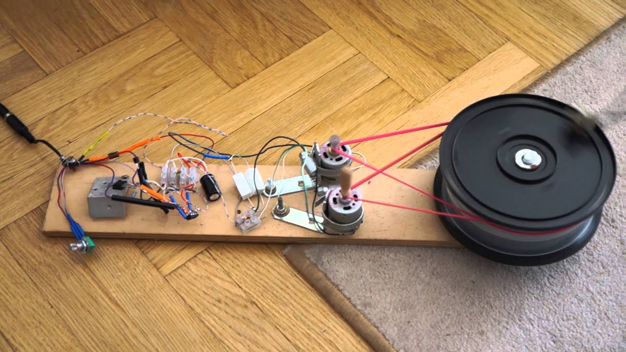

My first thought was:
Dual pulleys mounted to a gear motor
String wound on each pulley each in opposite directions and connected to the left and right side of the basket.
Motor control for forward and back motion
(I have seen this technique used to control RC boat sails)
Second was a bellcrank-like pulley and lever:
One pulley connected to a gearmotor
Lever connected to the face of the pulley on one end and to one side of the basket on the other.
Motor rotates continuously, the lever is free to rotate as the pulley turns so it moves the basket left and right.
You might get away with a motor (non-gear) and pulley with a string connected to one side of the basket.
Energize the motor to wind up the cord and swing the basket toward the motor under tension. Release the motor and the tension in the basket pulls the cord, basket and pulley in the reverse direction.
Entergize again for the next cycle.
