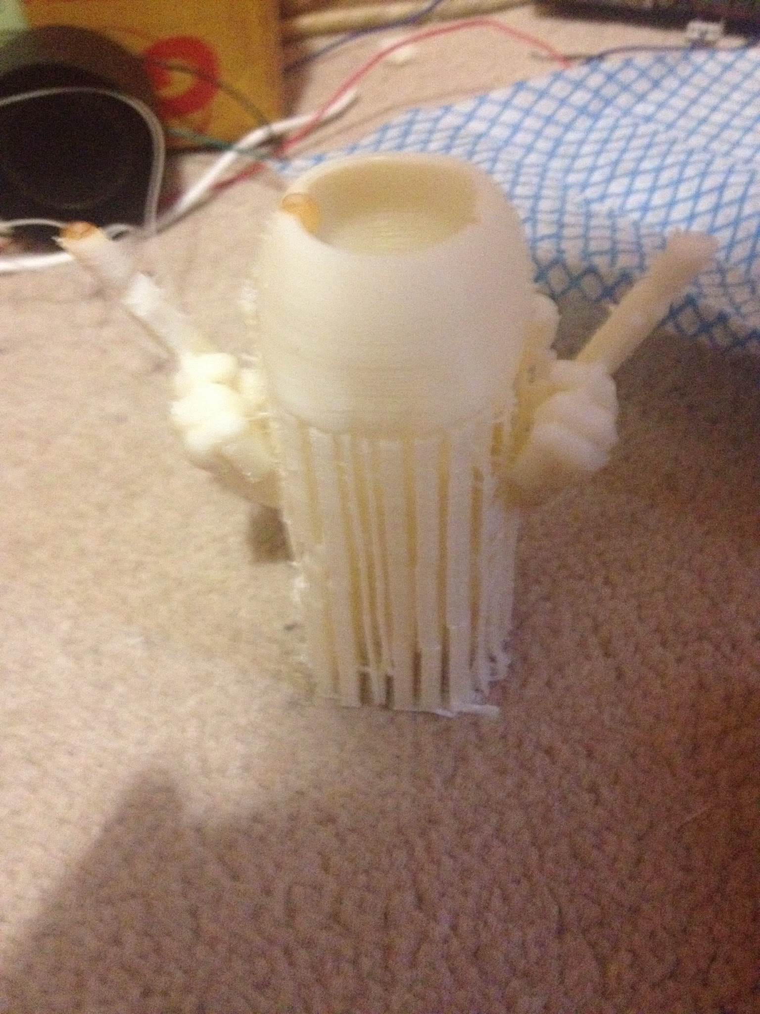

Awww, woke up to this this morning.
Awww, woke up to this this morning. Not quite sure why it stopped mid print
seems like comm problem. Maybe the controller driver crashed?
Would make a great egg cup. Or, even better, you could grow cress in it.
@Tim_Rastall ahhh, that’s a pretty cool idea :).
@Lukas_Merz quite possibly, I had to reset the printer to gain control again. I have been my printer quite a bit the last few days
theres a sensor that detects when youre not watching it.
I believe Samsung owns the pattend
Maybe a current and /or voltage problem?
@Lukas_Merz possibly, since getting a new nozzle the current seems to fluctuate more. I’m planning to get a new PSU at some point.
I may have move that up the “to get” list
or decrease the max stepper current?
@Lukas_Merz I did try that a few days ago but it’s worth giving it another go. Anything to save a few quid :slight_smile:
@John_Ridley yeah, I plan to do the same myself. Just need to get my Sainsmart LCD controller to work on my Megatronics board
So, I’ve figured out what the issue was here.
I had my max temp set in marlin to 270c and I was printing around that temperature.
So once this temperature was reached my printer shut down.
Once I tweaked these settings I’ve never had an issue.
