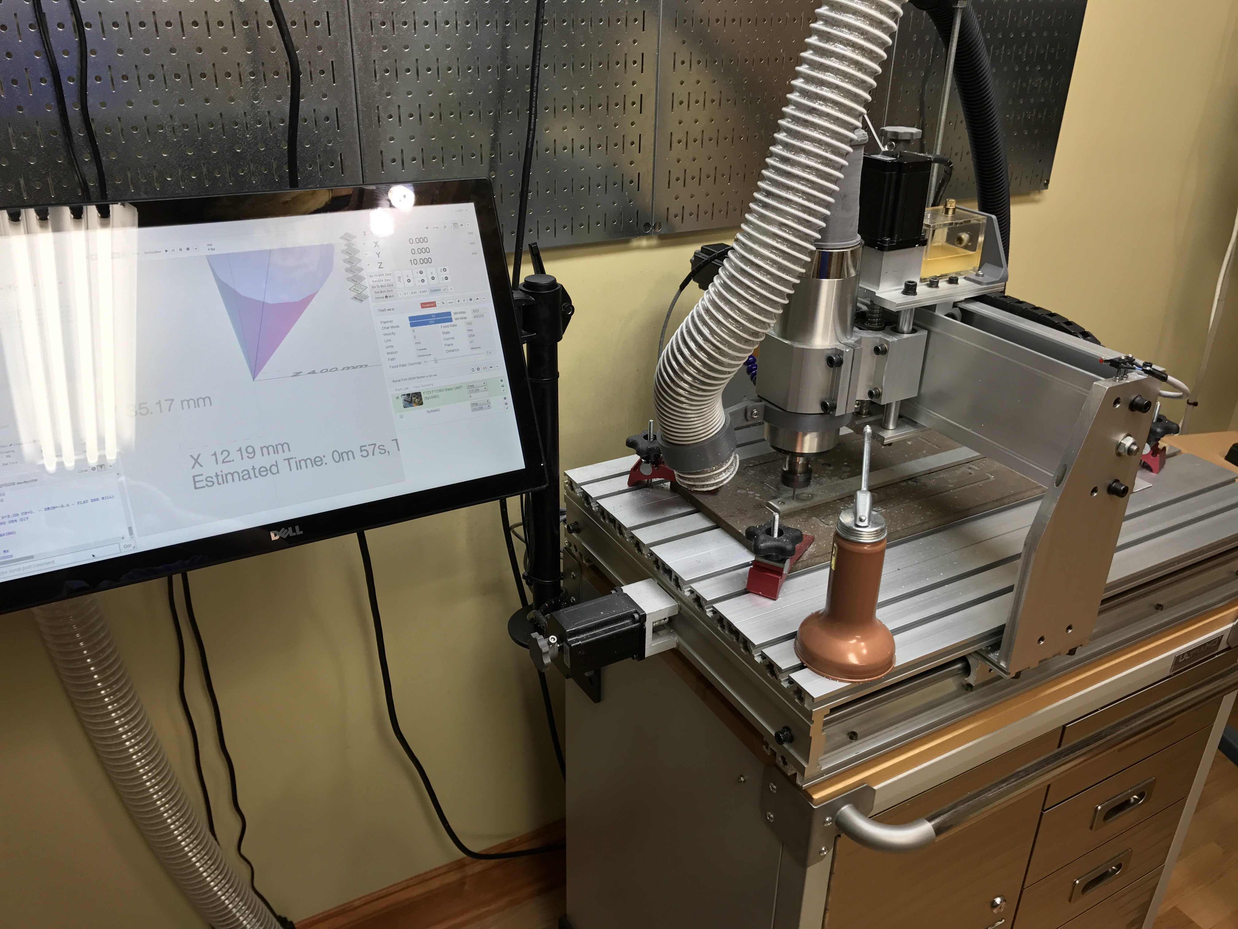

Back to building my 3d printer. Fixed some bugs with my 3dviewer on the pi. Found some new bugs too. No show stoppers, and I got a bunch of aluminum cut flawlessly.
