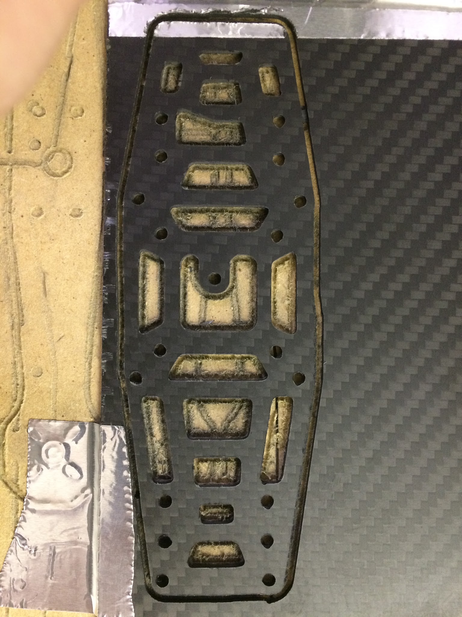

Back to the drawing board!!! My Ox started doing the same thing again sporadically shifting over mid cut. I have the 440.18 firmware on my TinyG now and thought that fixed the problem but that would be too easy.
How are you holding the stock down? Is it only the aluminum tape? Is the stock shifting during cutting or something?
It’s not shifting for sure. I’ don’t know what it is. Maybe the PC I’m running it with is not up to par some how?

no belt jumps I did feel a little thud when it would shift over felt like a bump. I was cutting 2 sheets of 2mm stacked on top of each other, I alum tape each sheet down securely, they do not move, not an issue. if the bit went off the edge of the carbon and had to dig its way back in at a shallow angle could this create enough resistance to hold the bit back some and reset the registration a few mm that way? I was cutting the 4mm of stacked CF in 3 passes of 1.54mm each to a 4.6mm max depth with my quiet cut spindle at 8000rpms

It’s obvious by some of your small pockets you have tool flex or spindle and or z flex happening. Are you climb cutting only?

I’m cutting that piece right now 200mpm and .6mm per pass 4 pass cut though 2mm CF 2.4mm deep we’ll see?
Successful so far. I’ll keep cutting shallow faster with more passes see if this the way to get good results with this machine.
