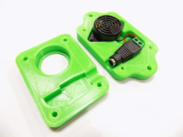

We added a added a water level alarm.
We made this alarm to let us know when the back up pump is running. This way, he knows that he needs to go buy a new primary pump.
The guts of the alarm consist of two items:
The 3D printed housing just holds them together. I used some button head #6 x 1/2" long sheet metal screws to hold the housing together.
