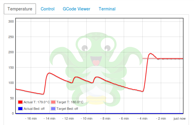

Baseline PID Autotune. What you see in this picture is the result of running an M303 with no additional parameters on a Hexagon hot end with no fan. That causes a 3 cycle Åström-Hägglund (relay) tuning around 100 degrees. Following that, the temperature is set at 180 degrees. The overshoot is too high and there is some ringing after.
