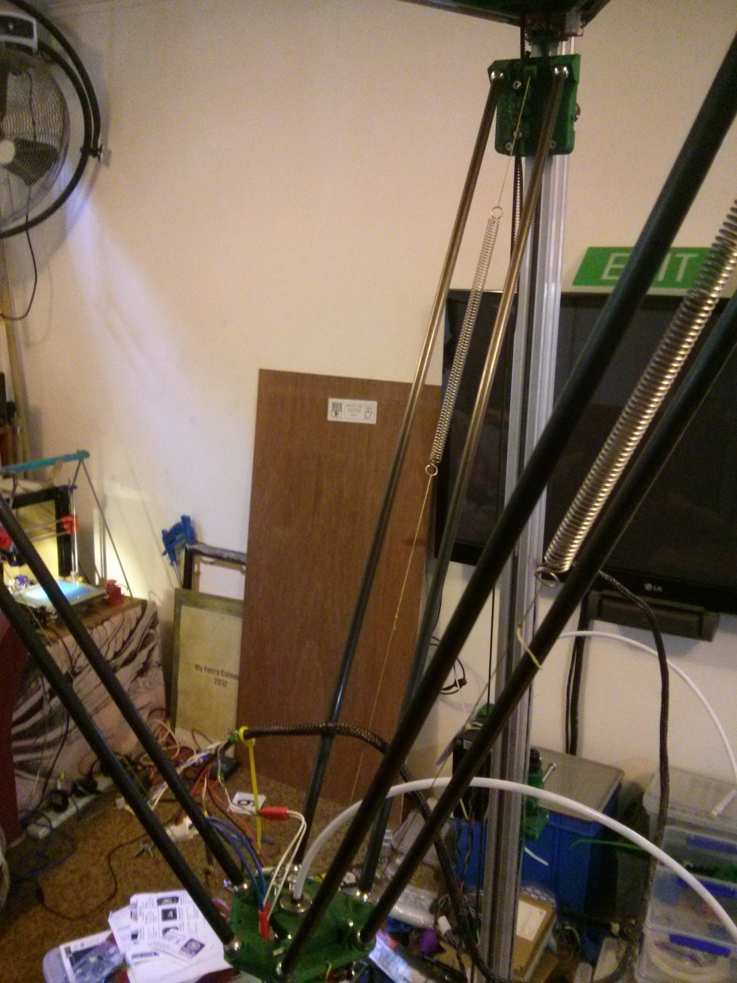

I’d suggest also looking at hardened balls in Delrin(Prototype is done in ABS) held in place by springs, rather than magnets. Steel on low frictions plastic and by changing the spring tention, you can control how much weight your head has. Plus you can keep the weight down by not having to have two lots of metal at either end.
We didn’t like the wear of steel on the soft nickel coating of the magnets, nor when the magnets let go, the head crashing into the bed.
This way, when it fails, is a bit spectacular, but the head ends up dangling on the retracted springs above the bed, rather than falling(In this case some 700mm) and crashing into the expensive glass bed.

@paul_wallich this sort of does that, the springs/cords hold the head dangling in the air. it wouldn’t take too much to also have the arms secured by loose thread to each carriage too, so they don’t go flying.
@Whosa_whatsis and I like the idea of detecting arm fails. It would need to be implemented in the head, a simple current loop up each arm, across the carriage and back down again to the next pair, along with some conductive grease on each joint and it would work. A bit overkill for a hobby machine but combined with filament jam sensors might be useful on a more professional machine.
A ‘safe’ fail is better than snapping or breaking something permanent!
