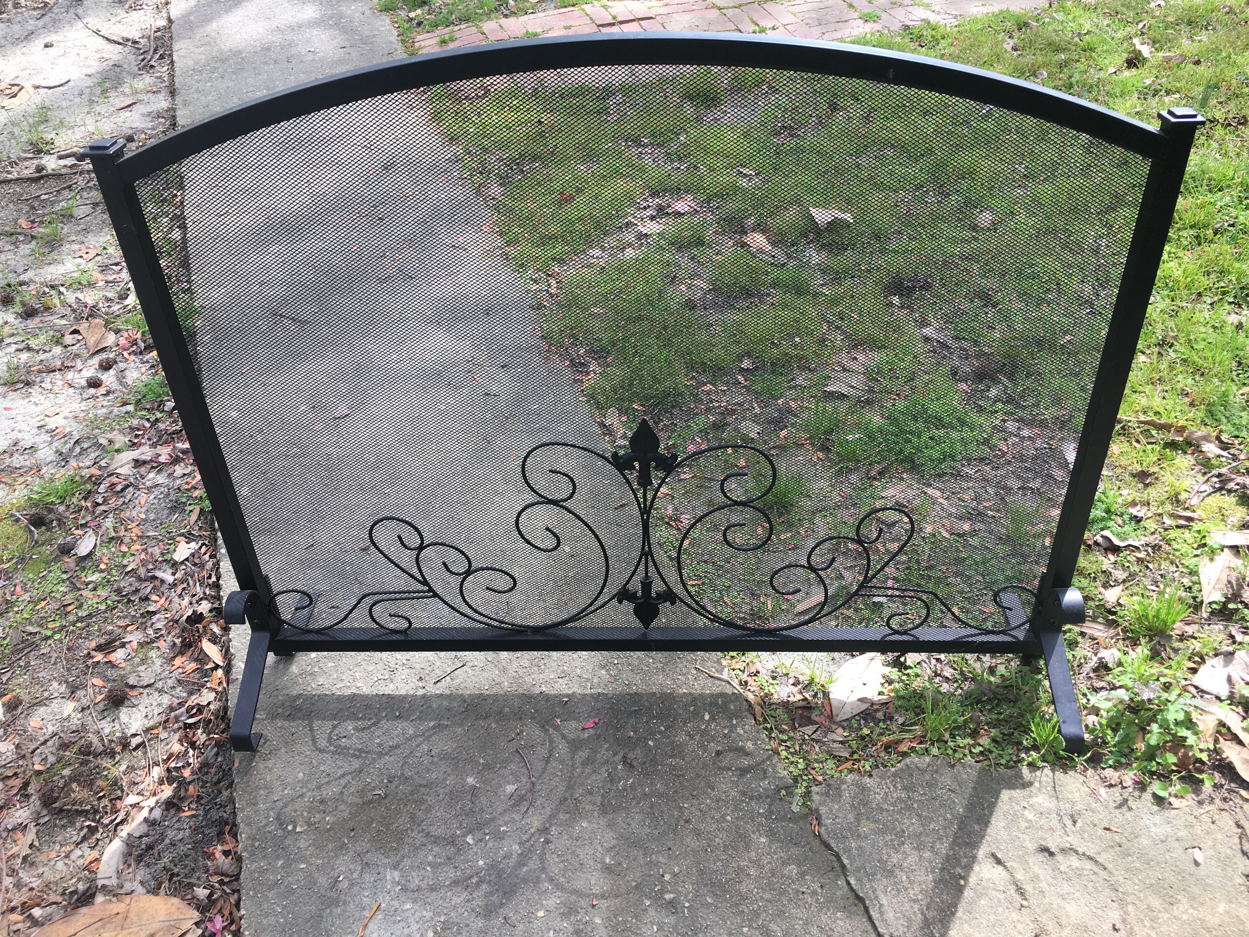

Was just walking the dog and found this fire place screen curbside that a neighbor was getting rid of. First thing I thought of was “hey this is what @funinthefalls needs” :smiley:
