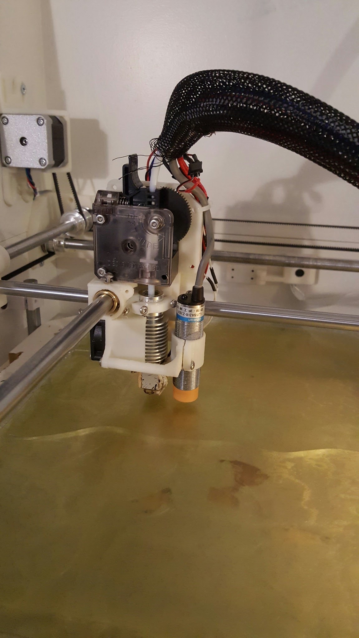

I am running a e3d titan direkt drive. Works great…
Thanks for the links @Eclsnowman . Missed that video… So sold now just because it looks so cool!

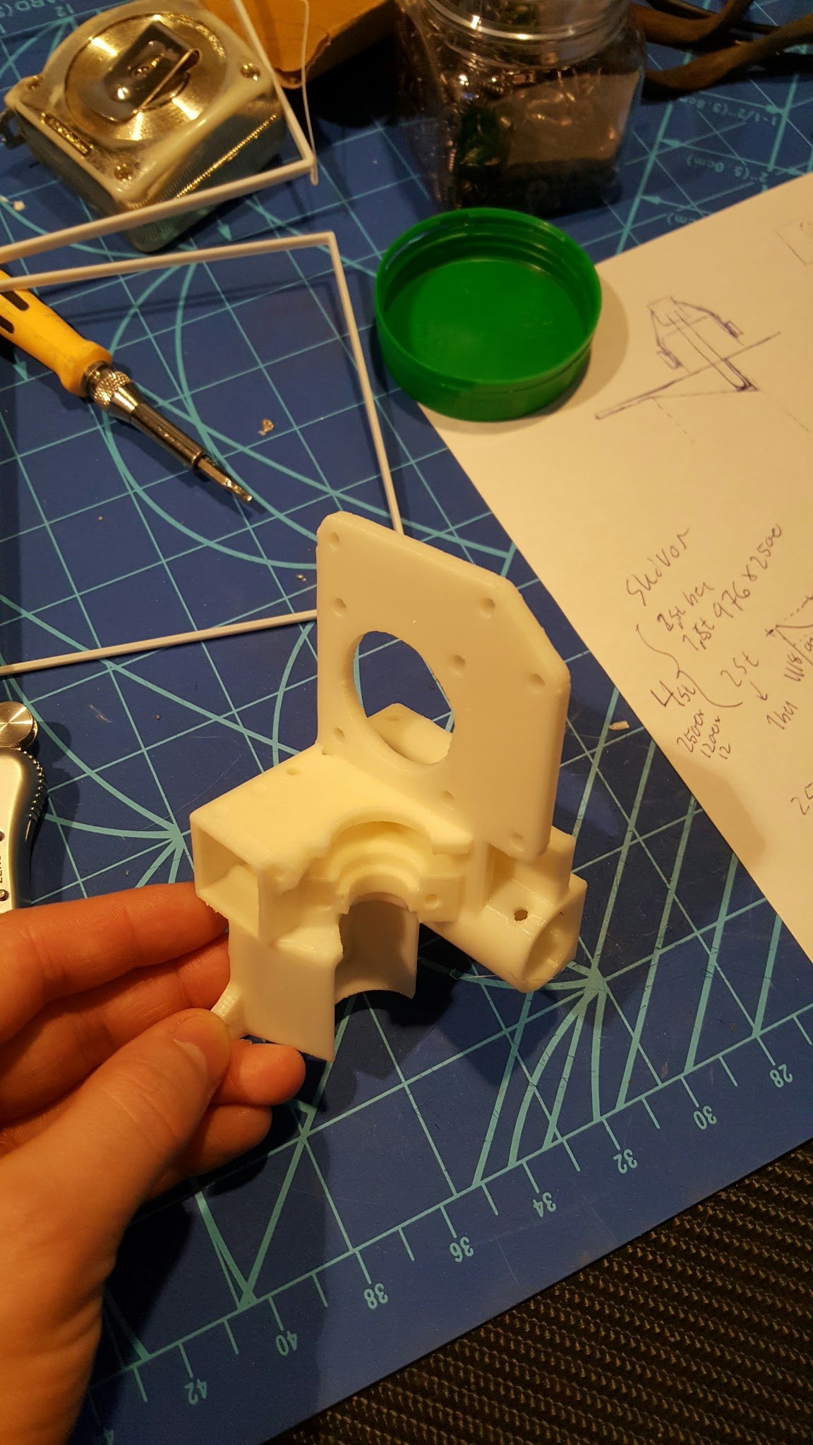

@Markus_Granberg do you have a mount for the Titan? Would be willing to give that a go too. I am just way too impatient and lazy to properly tune a Bowden. By the time I get it right from a given spool I’m out of plastic!
Cool! Can you share the STL? I have a few sets of bearings so could make that up and shove an e3d lite in it for flexibles. Does that mount also include the sensor? Would be very interested in giving that a go. We should get that mount added to the git repo too.
I will share the files when I get home
yes the sensor is a part of it to.
