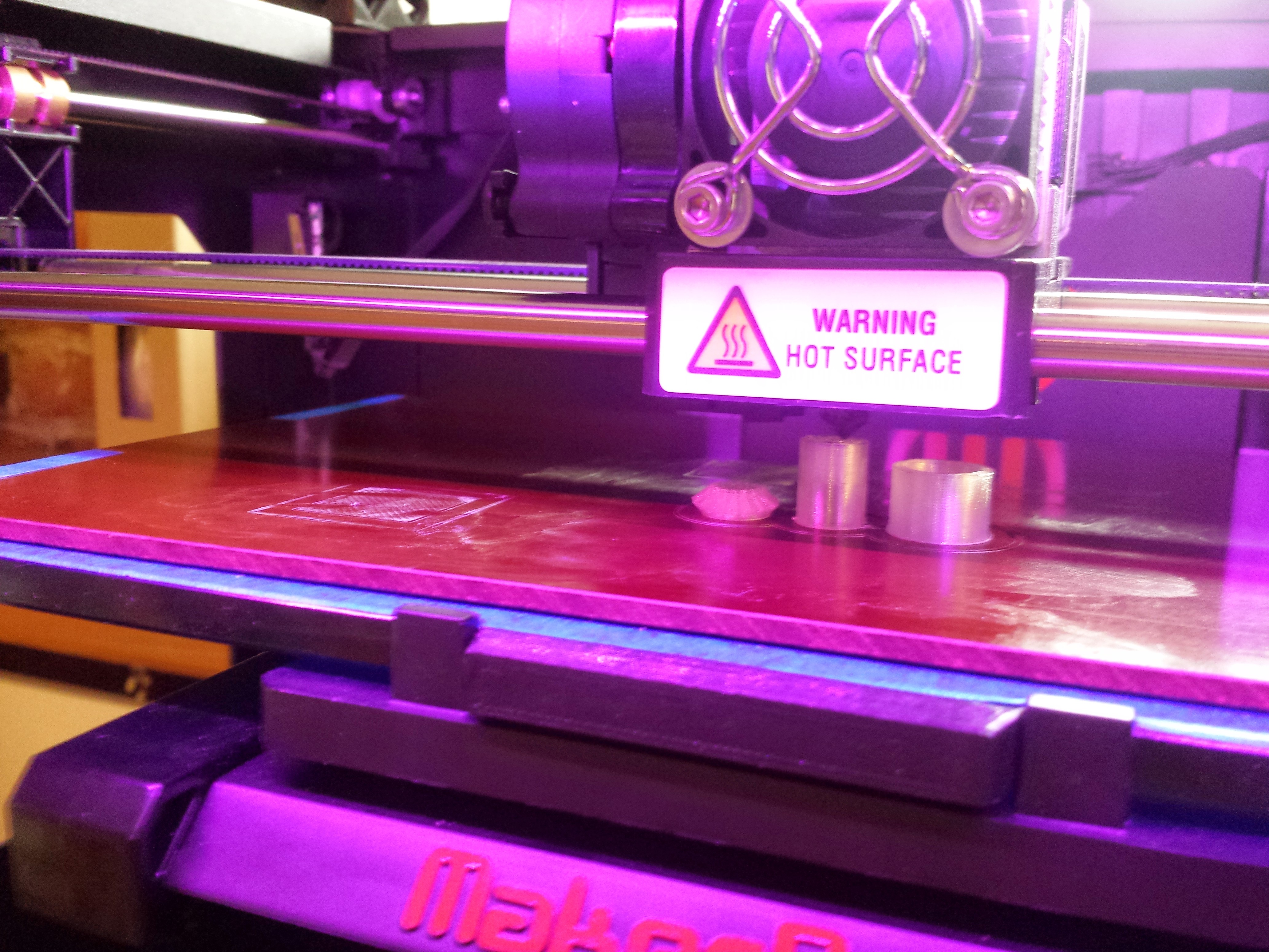

Been a while since my last update. Have been fiddling a lot with my printer, changed slicer followed by trying to print T-glase on my Rep2.
After quite a few hours I managed to get T-glase to stick on Bakelite with a thin layer of glue stick and pretty modified first layer (veeery slow and a lot of extra plastics extruded). As you can see on the pictures I’m now printing one of the parts for the front and back diffhouses. Not sure it will be dimensionally precise. Probably have some calibration left to do. But couldn’t wait to try to print this part when I got the layer adhesion good. Probably wont have time to do more testing today. But next week will hopefully provide more time.
