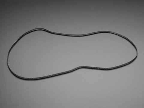

Timing Belt GT2 Profile - 2mm pitch - 6mm wide 1164mm long … does this need to be closed (looped/endless) ??

That is the closed belt for Z drive. I know they have it at adafruit also. It needs to be pretty close to that length to tension properly.
But I know robotdigg does have one very close.
thanks Eric, so will get the one from adafruit
thanks
If you do remember the robotdigg belt which can be used pls do let me know
thanks
Looks like the closest is 1140mm: http://www.robotdigg.com/product/270
This should work, the idlers will just be spaced further away… but that is fine.
