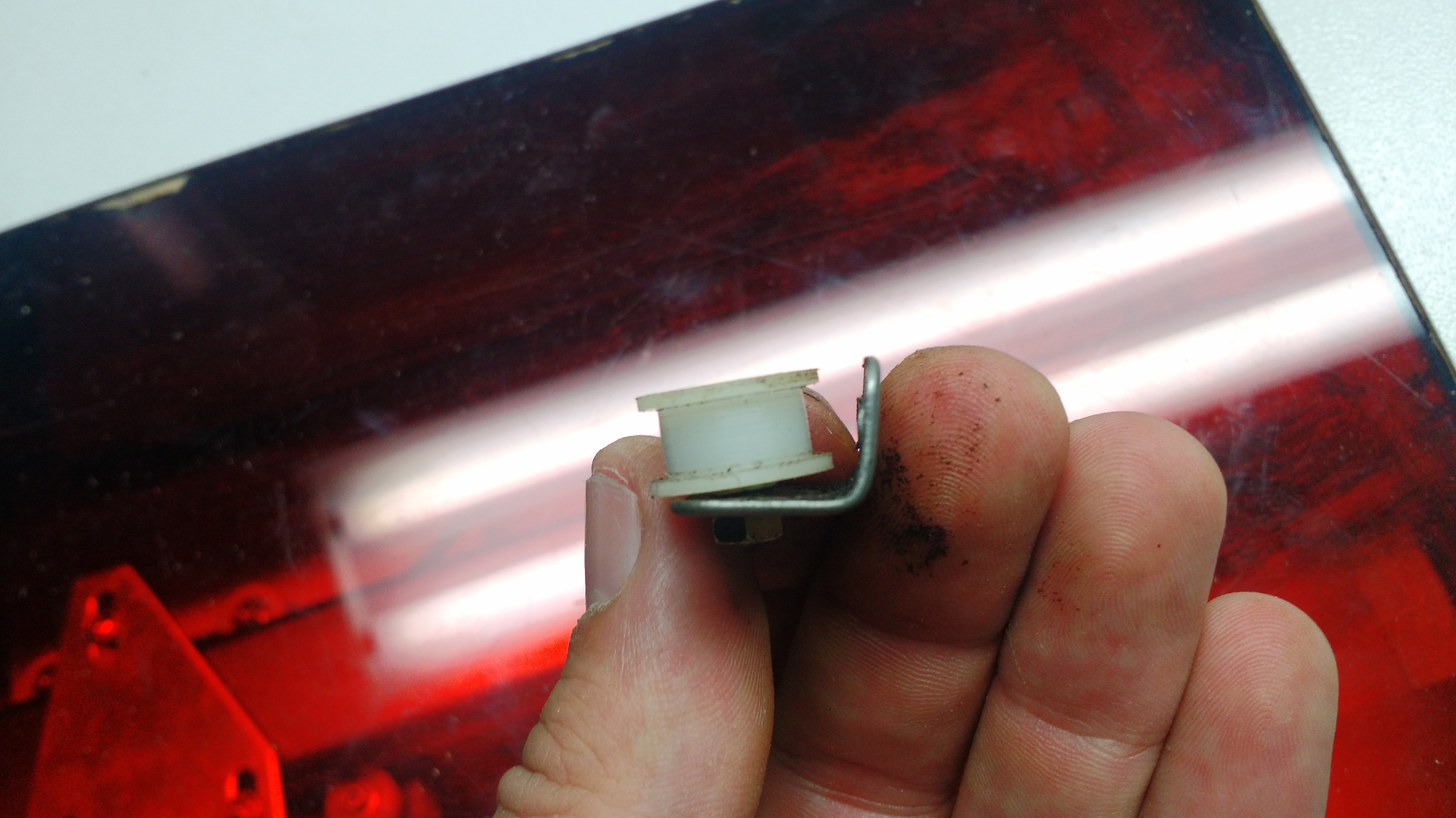

Been experiencing alot of line shifting and noticing a grinding noise when it happens...

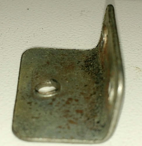

Been experiencing alot of line shifting and noticing a grinding noise when it happens… I removed the idler pulley from my X axis and saw this… the bracket is bent along with a .5mm burr from where they drilled the hole… looks like I will need to try and straighten things out along with removing the burr :frowning: laser is down and out for the time being… if I can’t fix it luckily Lightobjects has a replacement for it for 5$ + shipping

+Peter van der Walt​ lol I had thought about using a Precision Adjustment Hammer… I will take it to work with me tomorrow and use a vise and a Die grinder … hopefully good as new…
