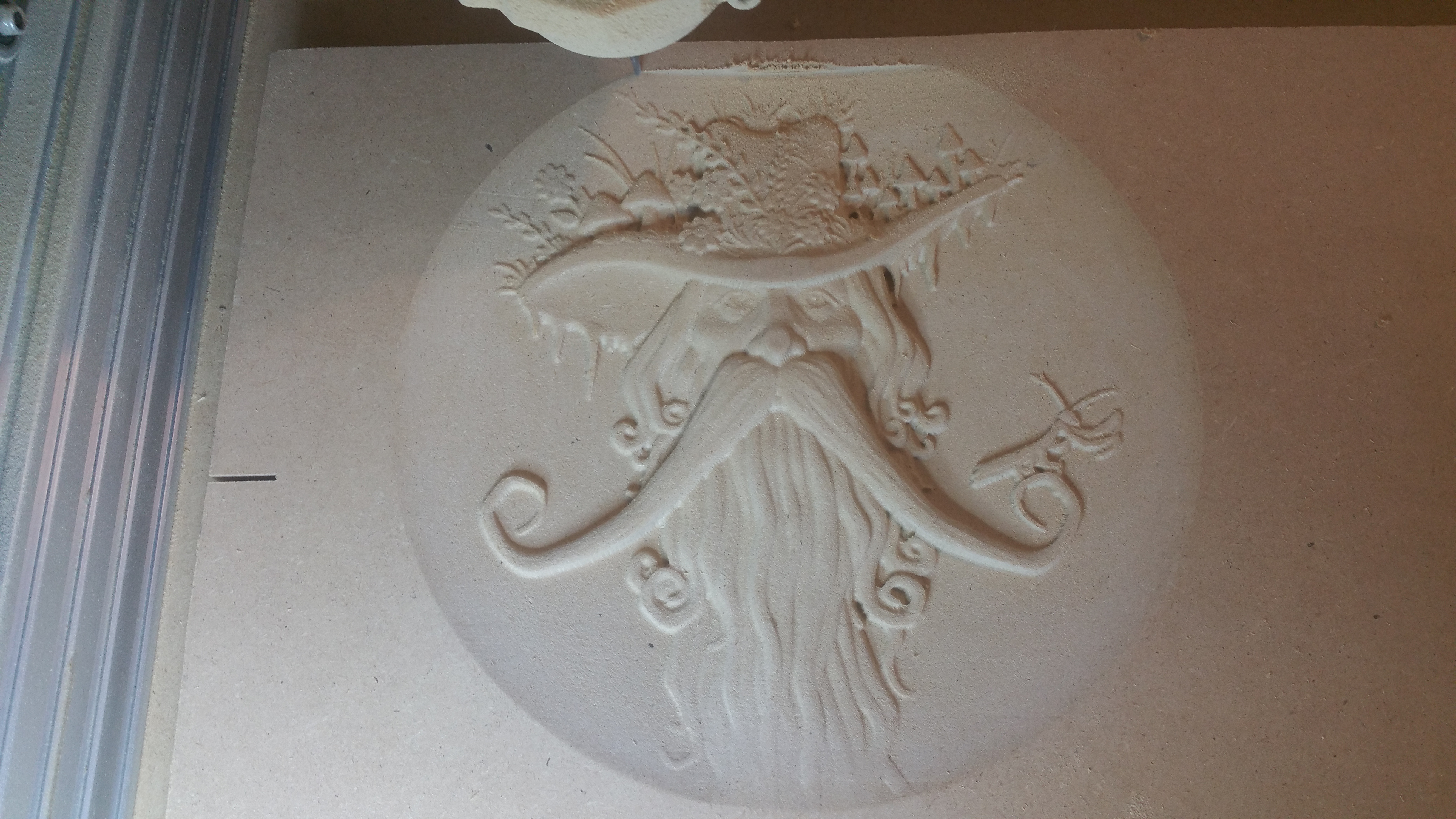

Been fine tuning and it seems to be working out. Thanks for all the help!

@Jamie_Wilson amazing sir, great looking wood too!
